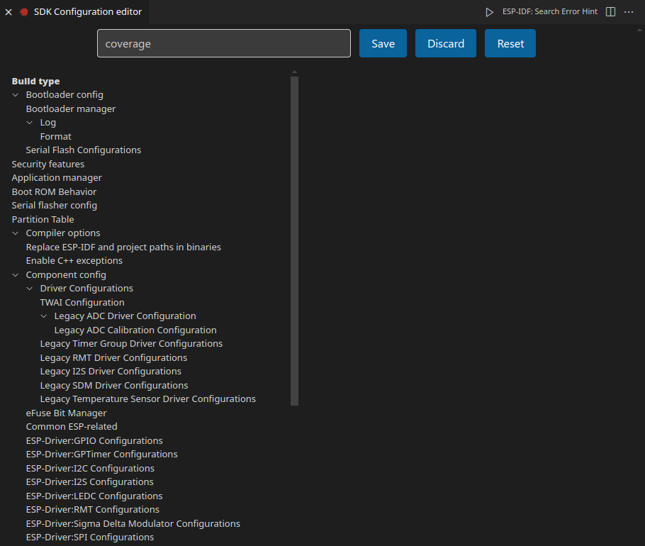

Then I've tried to set them manually in SDK Config interface, but nothing exists below the Component config about Application Level Tracing.
I've also tried with the idf.py menuconfig command, searched for apptrace options but found nothing about.
I really can't see those config symbols neither in the SDK Config interface nor in the sdkconfig file itself. Ain't those symbols should be generated automatically by Kconfig? How do I enable gcov for code coverage in this case?

I've tried adding the path of the app_trace as IDF_PATH/components as below but didn't work.
I've also tried adding those config symbols to a sdkconfig.defaults file as below:
# For IDF 5.0
CONFIG_ESP_TASK_WDT_EN=n
# For IDF4.4
CONFIG_ESP_TASK_WDT=n
CONFIG_APPTRACE_DEST_UART=y
# CONFIG_APPTRACE_DEST_NONE is not set
CONFIG_APPTRACE_ENABLE=y
CONFIG_APPTRACE_LOCK_ENABLE=y
CONFIG_APPTRACE_ONPANIC_HOST_FLUSH_TMO=-1
CONFIG_APPTRACE_POSTMORTEM_FLUSH_THRESH=0
CONFIG_APPTRACE_PENDING_DATA_SIZE_MAX=0
CONFIG_APPTRACE_GCOV_ENABLE=y
But when I clean and reopen the SDK Config UI I get the following output:
Loading defaults file /disk/Projeler/ESP-Components/relay_chn/test_apps/sdkconfig.defaults...
/disk/Projeler/ESP-Components/relay_chn/test_apps/sdkconfig.defaults:5 CONFIG_ESP_TASK_WDT was replaced with CONFIG_ESP_TASK_WDT_INIT
warning: unknown kconfig symbol 'APPTRACE_DEST_UART' assigned to 'y' in /disk/Projeler/ESP-Components/relay_chn/test_apps/sdkconfig.defaults
warning: unknown kconfig symbol 'APPTRACE_DEST_NONE' assigned to 'n' in /disk/Projeler/ESP-Components/relay_chn/test_apps/sdkconfig.defaults
warning: unknown kconfig symbol 'APPTRACE_ENABLE' assigned to 'y' in /disk/Projeler/ESP-Components/relay_chn/test_apps/sdkconfig.defaults
warning: unknown kconfig symbol 'APPTRACE_LOCK_ENABLE' assigned to 'y' in /disk/Projeler/ESP-Components/relay_chn/test_apps/sdkconfig.defaults
warning: unknown kconfig symbol 'APPTRACE_ONPANIC_HOST_FLUSH_TMO' assigned to '-1' in /disk/Projeler/ESP-Components/relay_chn/test_apps/sdkconfig.defaults
warning: unknown kconfig symbol 'APPTRACE_POSTMORTEM_FLUSH_THRESH' assigned to '0' in /disk/Projeler/ESP-Components/relay_chn/test_apps/sdkconfig.defaults
warning: unknown kconfig symbol 'APPTRACE_PENDING_DATA_SIZE_MAX' assigned to '0' in /disk/Projeler/ESP-Components/relay_chn/test_apps/sdkconfig.defaults
warning: unknown kconfig symbol 'APPTRACE_GCOV_ENABLE' assigned to 'y' in /disk/Projeler/ESP-Components/relay_chn/test_apps/sdkconfig.defaults
Are those symbols deprecated or what?

It turns out that this problem arises because the ESP-IDF can't find the configuration of the app_trace component. Although this wasn't mentioned in the relevant docs or the gcov example, the component should be declared in the test_app/main/CMakeLists.txt file as a REQUIRED component.
idf_component_register(
    SRCS ${srcs}
    INCLUDE_DIRS "."
    REQUIRES unity relay_chn app_trace
    WHOLE_ARCHIVE
