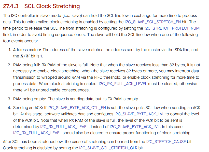

Hi Sir
In my project I am using ESP32-S3-MINI-1U-N8 as the main controller unit, It has 4 slaves in its I2C
1)EEPROM
2) Fuel Gauge
3)MPPT Charger
4) GPIO Expander
The LT8491 is battery charger IC whose input is from solar panel. When I probe the I2C SCL line of the MPPT charger LT8491 we found out that the I2C bus line its coming down from 3.3V to 2.2V when it is in IDLE condition that is not powered from solar panel and in the IC's datasheet its has been specified that the Master (ESP-32-S3-MINI-N8) has to support Clock Stretching for effective communication. Is there any way to enable this feature in ESP32S3miniN8. Also could you explain the attached image section specified in the technical manual and suggest a solution for this.

Sounds like the LT8491 is only using the solar panel as the power source, and effectively takes down the I2C bus when that doesn't provide enough power (probably because of internal ESD diodes conducting the I2C lines to a sagging power rails). Are you sure that chips EXTVCC is connected to something (e.g. the battery) that delivers more than 6.25V?The LT8491 is battery charger IC whose input is from solar panel. When I probe the I2C SCL line of the MPPT charger LT8491 we found out that the I2C bus line its coming down from 3.3V to 2.2V when it is in IDLE condition that is not powered from solar panel
The ESP32S3 supports clock stretching out of the box, no need to enable it.and in the IC's datasheet its has been specified that the Master (ESP-32-S3-MINI-N8) has to support Clock Stretching for effective communication. Is there any way to enable this feature in ESP32S3miniN8.
That applies to I2C slave mode and not to your situation as you're using the ESP32 as an I2C master.Also could you explain the attached image section specified in the technical manual and suggest a solution for this.

The ESP32S3 always has support for clock stretching enabled.Could you please explain this ?The ESP32S3 supports clock stretching out of the box, no need to enable it.
Then that is your problem. The LT8491 is getting starved for power, and tries to draw current from your I2C lines to stay alive; unsurprisingly, an I2C bus doesn't really like chips using it as a power supply so the entire bus collapses. You need to make sure your LT8491 stays powered; that is the core of your problem.Yes LT8491 is only powered from solar panel, we have tried that but could not get it to work."Sounds like the LT8491 is only using the solar panel as the power source, and effectively takes down the I2C bus when that doesn't provide enough power (probably because of internal ESD diodes conducting the I2C lines to a sagging power rails). Are you sure that chips EXTVCC is connected to something (e.g. the battery) that delivers more than 6.25V?"
