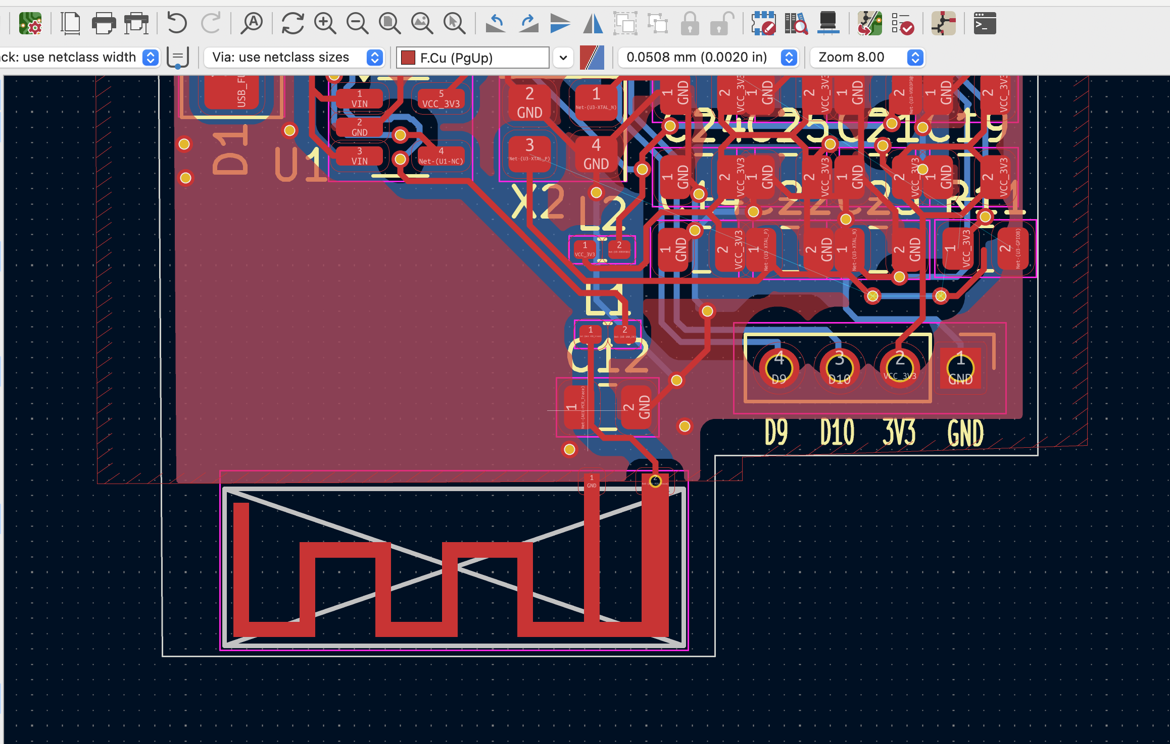

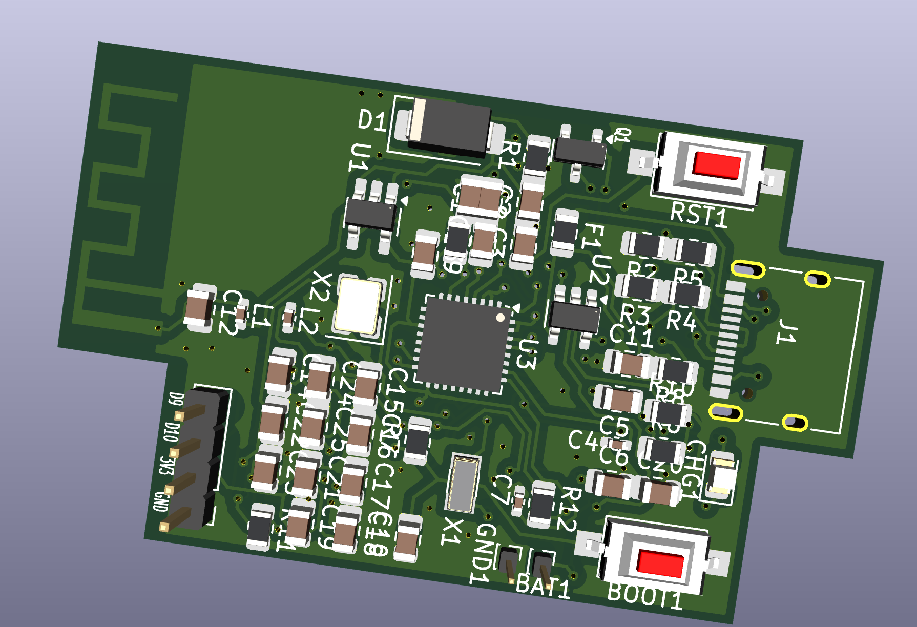

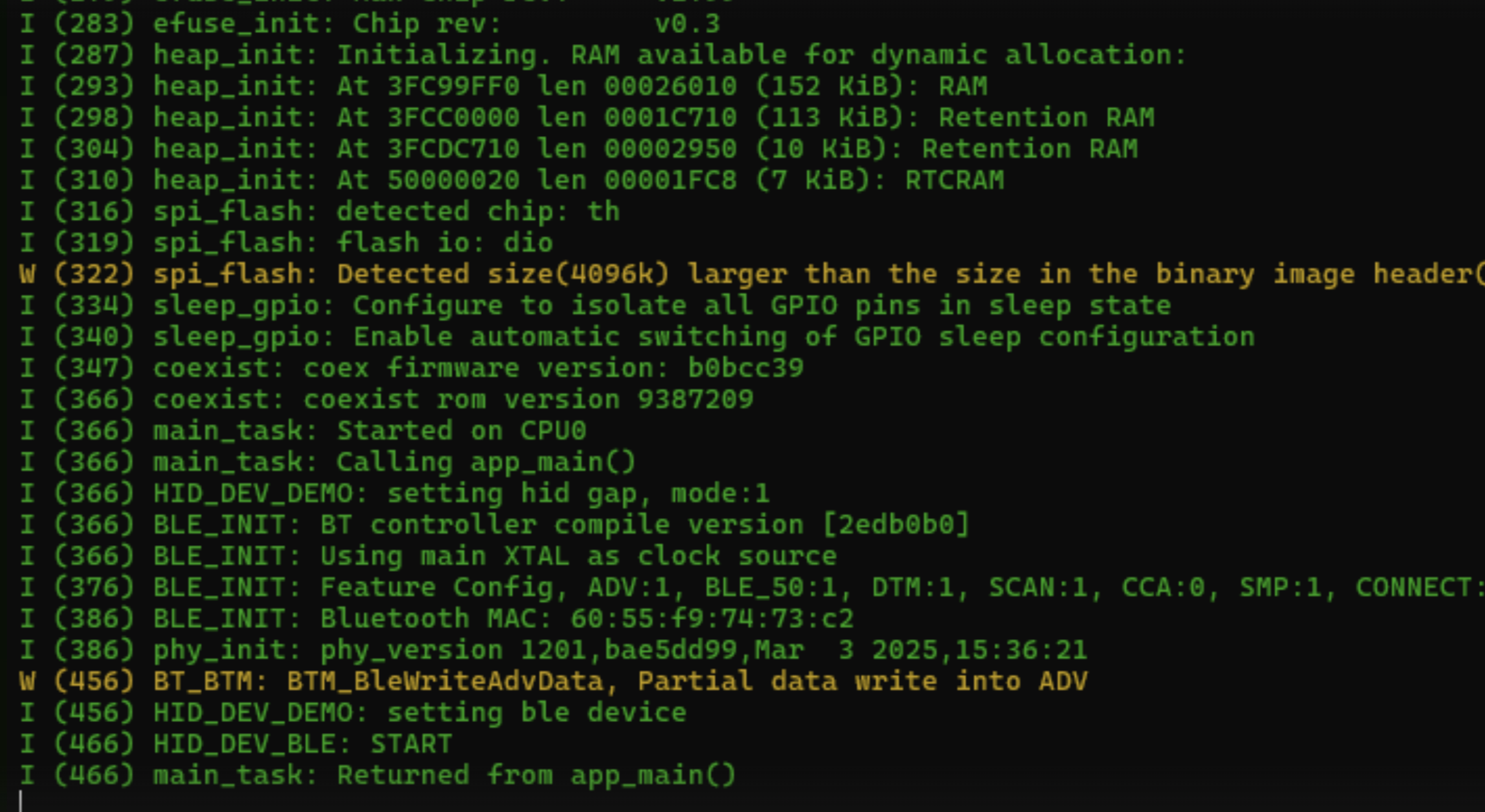

I fixed the above problem by wiring GPIO2 and GPIO8 to 3v3 connected with 10k resistor and now I have problem with antenna when ESP32C3 chip has started Bluetooth, started broadcasting BLE but I can't scan BLE with phone. I tested on another ESP32C3 module and can scan BLE, this proves my code works fine but RF has problem. I hope you can help me double check the components in my circuit diagram have reasonable values?
- Screenshot 2025-10-03 at 17.25.27.png (1.31 MiB) Viewed 2334 times
Re: Custom ESP32-C3 not detecting COM port
That's very hard to debug remotely, as it depends on your antenna configuration, PCB layout, etc. You don't happen to have an >8MHz VNA laying around?
Huy_Tran_DF
- Posts: 18
- Joined: Fri Sep 26, 2025 9:44 am
I don't have a VNA device
The footprint I used for the BLE antenna is: RF_Antenna:Texas_SWRA117D_2.4GHz_Right
I think the problem is that the L1 and C12 values are not matched, is this correct?
- Screenshot 2025-10-04 at 08.14.10.png (489.5 KiB) Viewed 2320 times
- Screenshot 2025-10-04 at 08.12.22.png (552.2 KiB) Viewed 2320 times
There's a lot more wrong with the PCB. You're running a data trace under the (sensitive) crystal, I don't see the matching caps anywhere near close to it, your (very sensitive, should be as short as possible!) LNA line meanders everywhere and has vias in its path; it's also not impedance matched, you have almost zero ground stitching, and those are just the issues I see at first glance.
I'm gonna be honest with you: I don't think this PCB can be saved. Even if you can figure out and fix the things that make it not work at all, the rest of the issues will still lead to a bad performance, and given you don't have a VNA, you're flying blind as to why it's not performing to begin with. One thing you can do is design a new PCB and religiously follow the design guidelines of the ESP32-C3, but if you excuse me inferring your RF knowledge from your current design, I think you'd be better off using one of our modules (or this one) instead; we have them as they make sure the deeper RF magic is correct in them and you only have to worry about placing the antenna properly.
