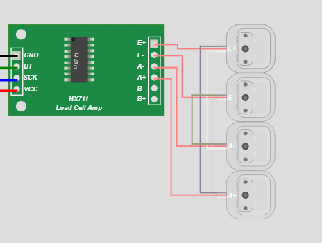

i'm trying to build an weight scale with with the Liliygo T-Zigbee Board using an HX711 and 4x 50kg weight cells. I get different reading on every calibation and the reading dont really change as expeced on adding or removing weights on the cells and the measurement drifts.
I have rewired it multiple times already to make sure there are no mistakes there. I changed the the DT and SCK Pin connection to other GPIO-Pins without success.
I don't really know what else could be wrong. Could someone take a look and give me advice what i should change to get correct measurement and calibation.
The HX711 and the loadcells are wired like this
HX711 wiring.PNG (20.05 KiB) Viewed 2485 times

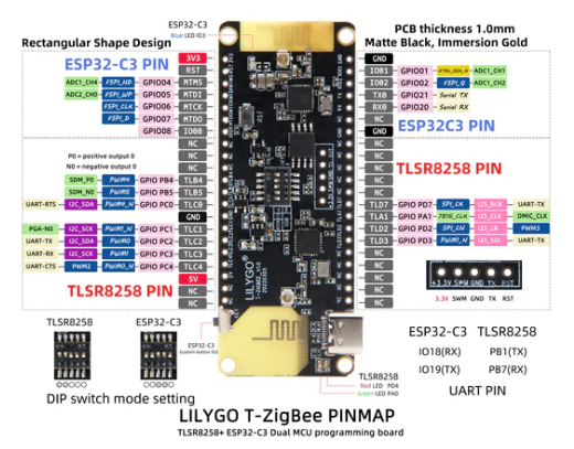

The HX711 is currently connected to the board as follows
GND -> GND
DT -> GPIO08
SCK -> GPIO06
VCC-> 3.3V
And The Pins on the board are like this

You should read the HX711 datasheet. I don't think it works the way you are thinking- it is intended to be a differential reading between two poles on a strain sensor, and provide 2 such inputs. If you just want to read multiple analog inputs, the esp32 can do that directly, or you can get a device like ADS1115.
https://cdn.sparkfun.com/datasheets/Sen ... nglish.pdf
TinTin
Joined: Sat Jun 08, 2024 10:07 am
Re: Weight Scale on ESP32-C3 on Liliygo T-Zigbee Board
Postby TinTin » Mon Jun 10, 2024 8:53 am
Hello lbernstone,
yes i know that. Thats the reason the 4 halfbridge weight cells are forming a Wheatstone bridge so that on applying pressure on them the resistances change and the voltages on the inputs A+ and A- change accordingly. And the HX711 should amplify that input signal.
I took this as example for my setup
https://randomnerdtutorials.com/esp32-load-cell-hx711/
the difference to my setup there is that i use 4 halfbridge weight cells to form a full bridge weight cell and they use a different board. But it still uses an esp32 in that board.
And there are multiple setups there they use the same loadcells with the hx711 and the same wiring of the loadcells to the hx711 but instead with an arduino board and it works.
So i dont think I'm wrong in that part.
What i suspect is that maybe the internal ADC of the board trys to convert an alredy digital input. But that should not be it because i changed the pins to which the hx711 is connected to board.
Or its something i'm just to blind to see.
