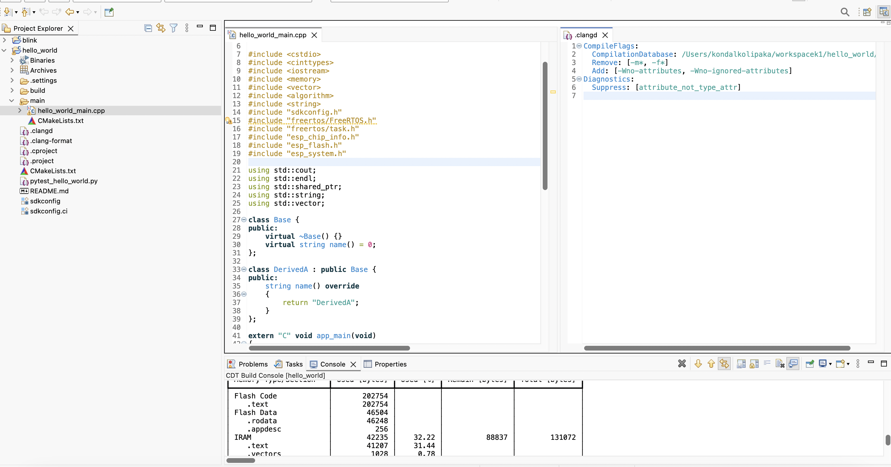

I was trying to reproduce this behaviour with the similar headers!
Build is fine - this is an IDE indexer (clangd) false error, not a real compile issue.
How to fix:
- update .clangd to avoid this false-positive escalation:
CompileFlags:
  CompilationDatabase: build
  Remove: [-m*, -f*]
  Add: [-Wno-attributes, -Wno-ignored-attributes]
Diagnostics:
  Suppress: [attribute_not_type_attr]
What's happening:
- ESP-IDF uses the Xtensa GCC toolchain and compiles successfully.
- clangd (used for editor diagnostics) parses some picolibc headers differently.
- In pthread.h, clangd misinterprets __noreturn and reports:'noreturn' attribute cannot be applied to types. Because warning policy includes -Werror, clangd shows it like a hard error near <iostream>
Screenshot 2026-04-28 at 1.53.13 PM.png (1.63 MiB) Viewed 31 times
