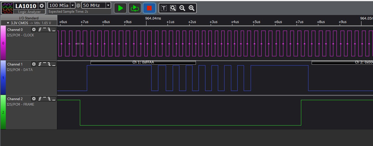

I'm working on a USB to I2S bridge targeting 32 bits x 8 channels and 96kHz. It is to be based on ESP components esp_codec_dev and usb_device_uac. First implementation with i2s 16 bits stereo is working with my Codec, but I don't have sound when I configure usb_device_uac with 32 bits samples. I2S is configured in master mode.

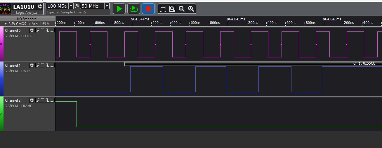

With the logic analyzer I identified that I have data bits edges not in sync with the bclk falling edges. See first attachment.
Hoever on the same board and similar initialization, the i2s peripheral example has its data edges well synchronized with the bclk (same board, same pins, same measurement setup.
Not OK one not synch
Capture d’écran 2026-07-24 212002 32bits 48k I2S debug.jpg (84.74 KiB) Viewed 18 times
i2s std example OK on same chip
Capture d’écran 2026-07-24 212002 32bits 48k I2S std correct.jpg (104.9 KiB) Viewed 18 times

I did additional tests. In my code, based on the usb_device_uac component and example, I was initializing the rx channel of the i2s ( i2s_new_channel(&chan_cfg, &i2s_tx_handle,&i2s_rx_handle))). Then I was initializing it (i2s_channel_init_std_mode(i2s_rx_handle, &std_cfg)) and enabling it (i2s_channel_enable(i2s_rx_handle)) before the tx channel. As the code was configured for 2 speakers channels and no inputs, the rx channel was not read by the code.
Removing the configuration of the rx channel from my code seems to address the issue: now the tx data bits edges are aligned with bclk.
Could it be some "interference" between the tx and rx channels of the peripheral ?

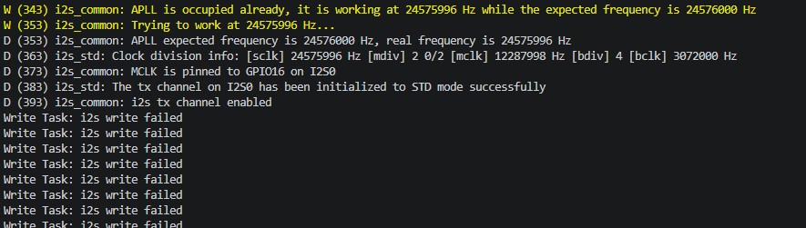

I did some additional tests, re-activating the different i2s_rx setup:
- i2s_new_channel(&chan_cfg, &i2s_tx_handle,&i2s_rx_handle) => this does not creates an issue,
- i2s_channel_init_std_mode(i2s_rx_handle, &std_cfg) => There is an error when I try try to write using &i2s_tx_handle !!!! See attached printscreen,
- i2s_channel_enable(i2s_rx_handle) => Now the writes succeed, but the edges are not in sync with bclk.
I haven't seen in the documentation any instruction or warning preventing to configure the rx channel if we are not using it... I would be happy to better understand the issue.
Error writing tx if rx is not enabled.jpg (65.28 KiB) Viewed 5 times

Postby MicroController » Sun Jul 26, 2026 8:13 pm
In your code, you're initializing two channels with the same i2s_std_config_t; i.e. you tell two channels to use the same pins (like you would do for one full-duplex channel). This might be causing issues.
