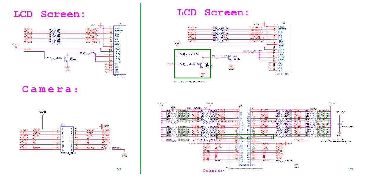

i build with DevKitC/Nano32 again and the OV7670, prinzipal works now.
must study the shematic from wRover kit V2,
there was a change on few pins,
one thing ,more, the QV7670 need pullups on SCL and RST must be pulled up ( 3.3 ) , the PWRDWN must pulled down ( GND ).
then OV7670 is talking SCCB, this result comes from "long night" testing,
for flashing with OV7670, break short RST from 3.3
http://esp32.com/viewtopic.php?f=12&t=344
btw the lcd D/C is same like Xclk.

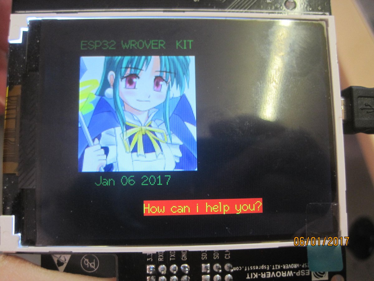

( from SPI Flash )
"animated help service with audio" 8-)
on right side comes a live vid frame later.
