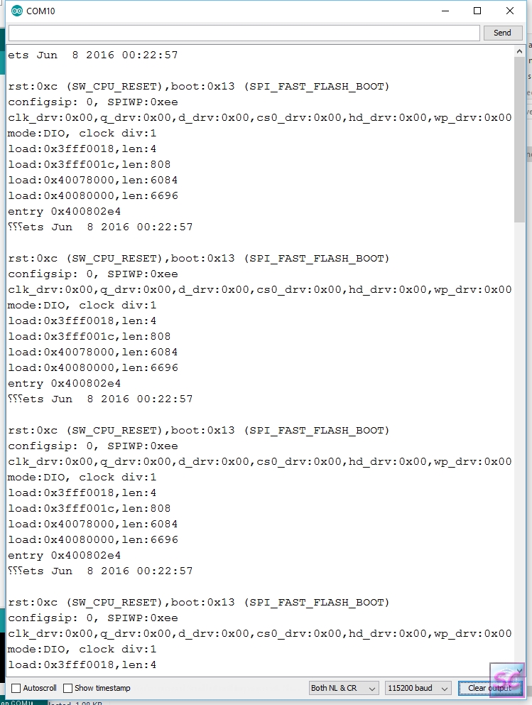

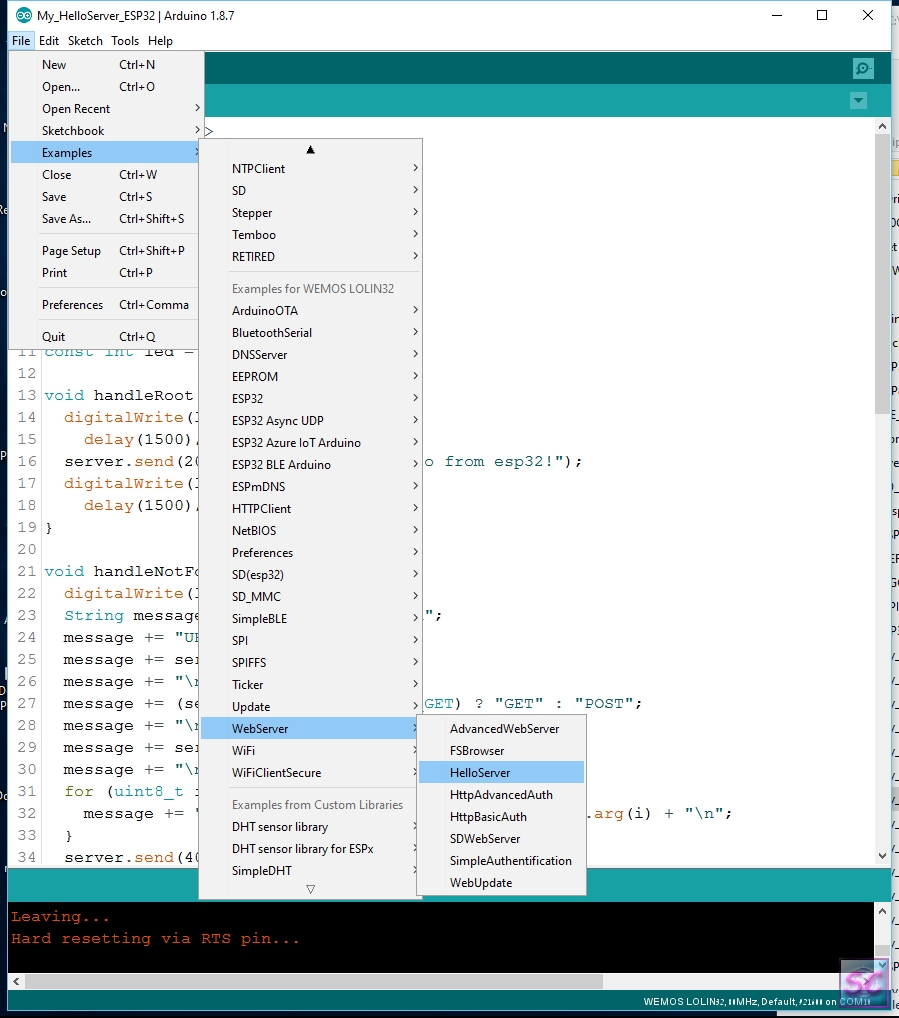

When I burn the following code from the examples: see picture.
In the IDE terminal, I see an endless scroll of software. see picture.
The same problem exists with the second panel, I think there is still a problem with the settings,
And I do not know where, I will thank you very much, or anyone who can help me.

Re: [Solved] Problem with compiling
The problem is resolved using the following link.
https://randomnerdtutorials.com/solved- ... et-header/
Many thanks to the site Random Nerd.
