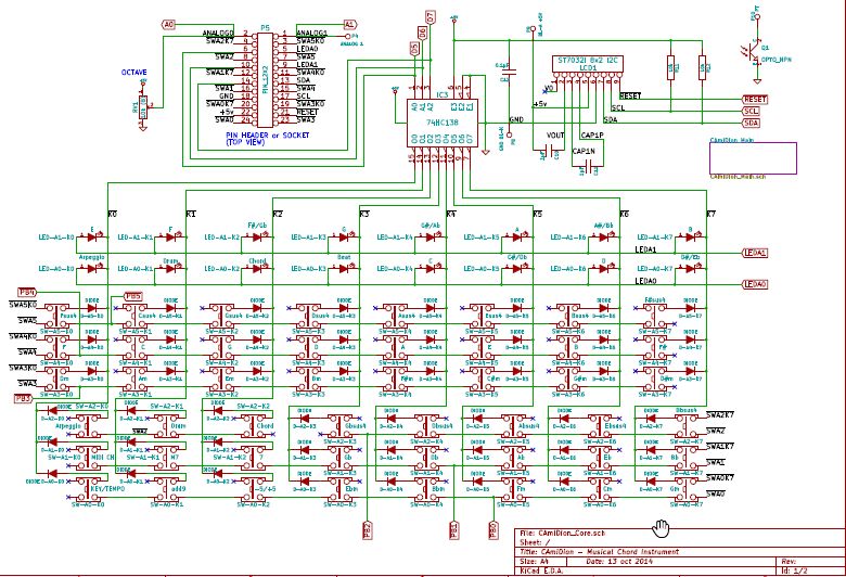

Here is the circuit with 48 buttons(6 rows × 8 columns). And here is a piece of schematic. this circuit worked in the expected way.

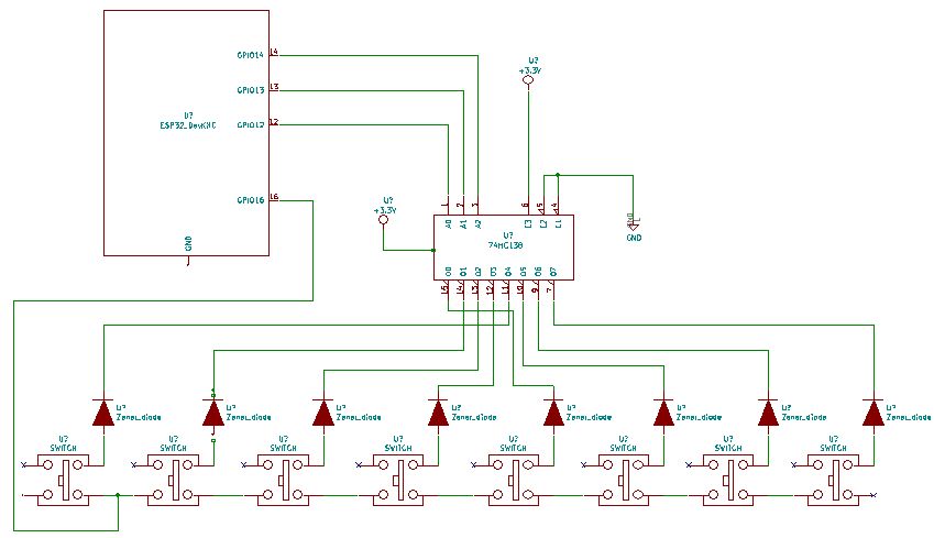

Yosuke,
In the diagram above it appears that the 138 is being used for 2 output purposes: 1) to send a polling signal to each of the 8 columns (of 2 switches) and combined with led0/1 to light 1 of the 16 leds (8 columns 2 rows).
The switch values are presented to the long connector which chooses what row of switches and what column and through the 138 which led row and column. The 138 is used as output only and is being used correctly
The process is polling which returns column switch values to the long connector no to the 138.
For your purpose a 148 is the correct part and is easily chained or matrixed to read more switches.

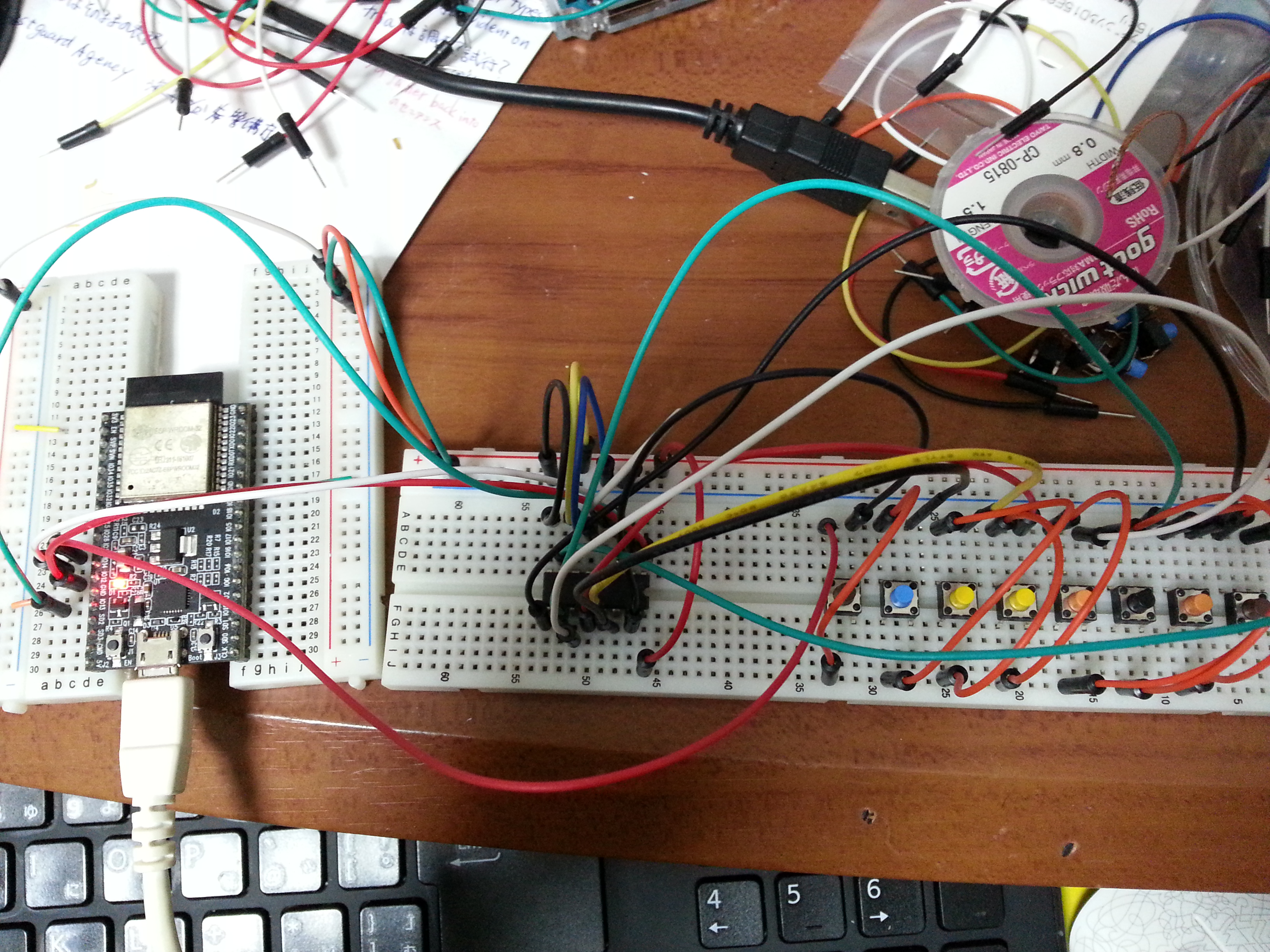

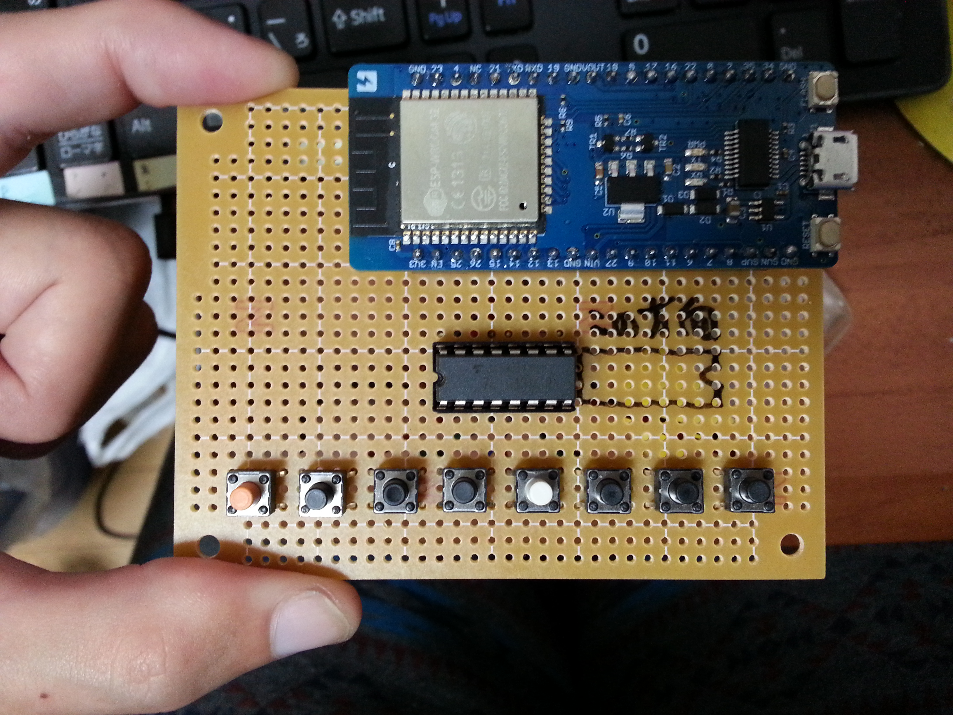

I used universal board because breadboard might cause that defect.
And I used my code(Version 1), but the result was the same.
When I pressed #0 switch, I got 4. ←wrong
When I pressed #1 switch, I got 1. ←right
When I pressed #2 switch, I got 2. ←right
When I pressed #3 switch, I got 1 or 3. ←wrong
When I pressed #4 switch, I got 6. ←wrong
When I pressed #5 switch, I got 5. ←right
When I pressed #6 switch, I got 0. ←wrong
When I pressed #7 switch, I got 7. ←right This defect happens under any circumstances.
On the other hand, if I change the wirings appropriately, it is no longer a problem except #3 switch.

I changed the wirings appropriately(#0 switch → PIN 4 of HC138 and #4 switch → PIN 0 of HC138).
When I pressed #0 switch, I got 0. ←right
When I pressed #3 switch, I got 3. ←right
When I pressed #4 switch, I got 4. ←right
When I pressed #6 switch, I got 6. ←right
All right! Yeah

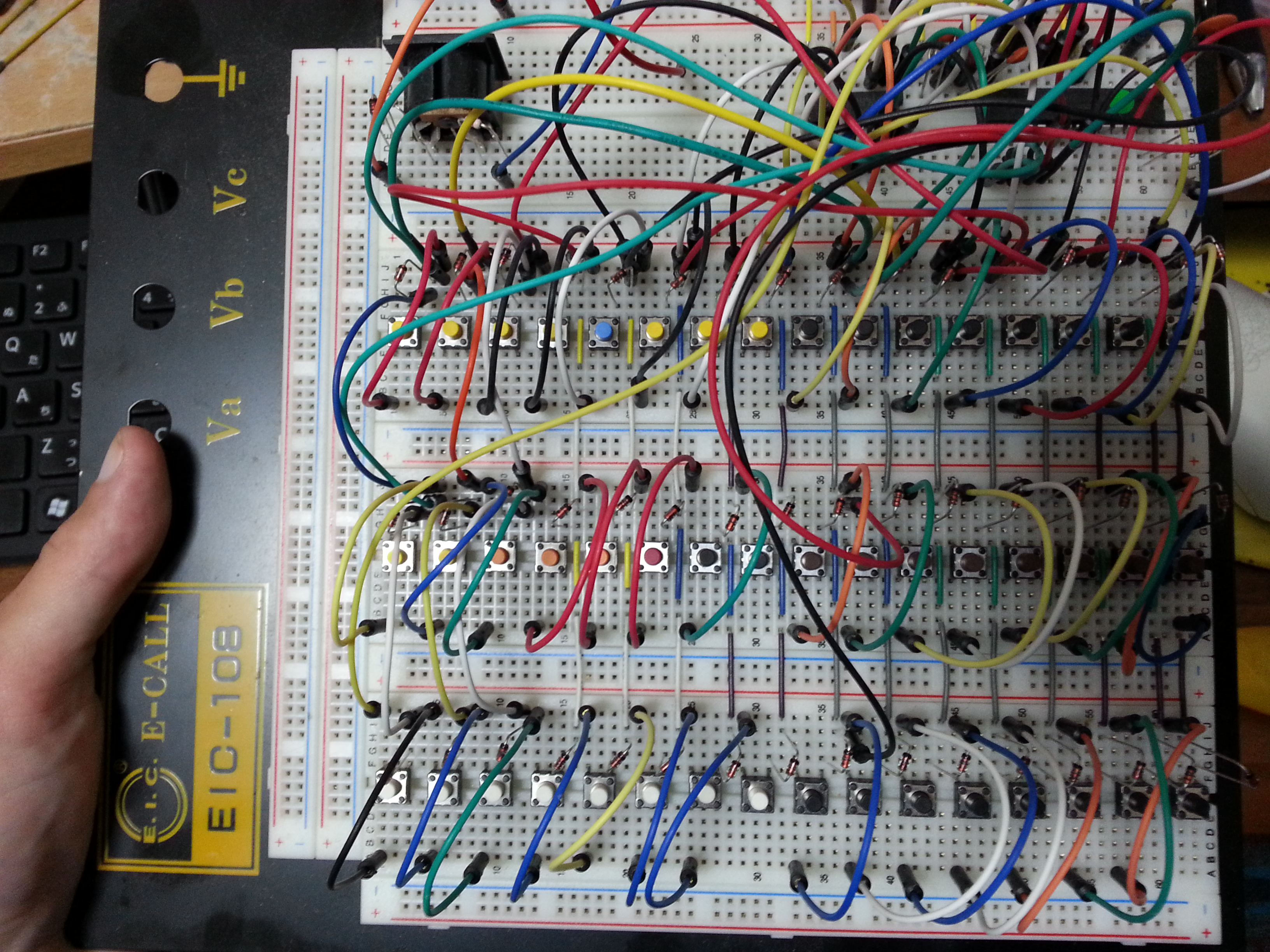

I added diodes(one diode per one button) to my circuit, but I can't press multiple buttons at the same time.

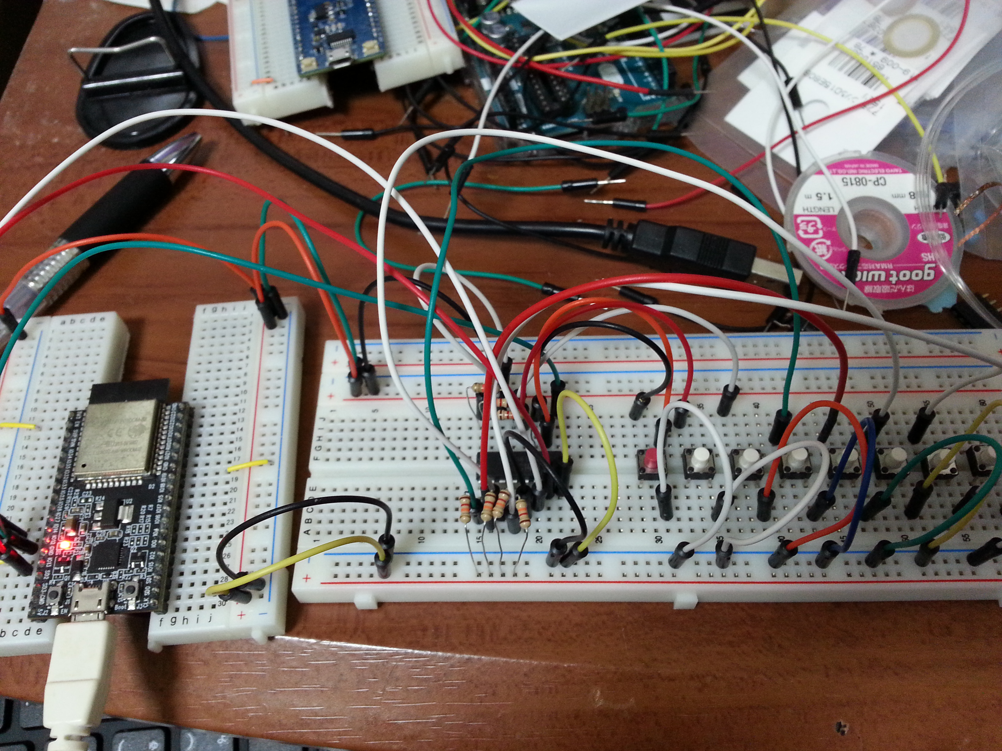

I recieved 74HC148 and I tried to verify it with ESP32, 7 switches, and 7 resisters(12K).
The result was not what was expected. Here is my codes.
The result was;
When I pressed #3 switch, I got 2 or 3. ←wrong
When I pressed #5 switch, I got 4 or 5. ←wrong
When I pressed #6 switch, I got 4 or 6. ←wrong
When I pressed #7 switch, I got 4 or 6 or 7. ←wrong
