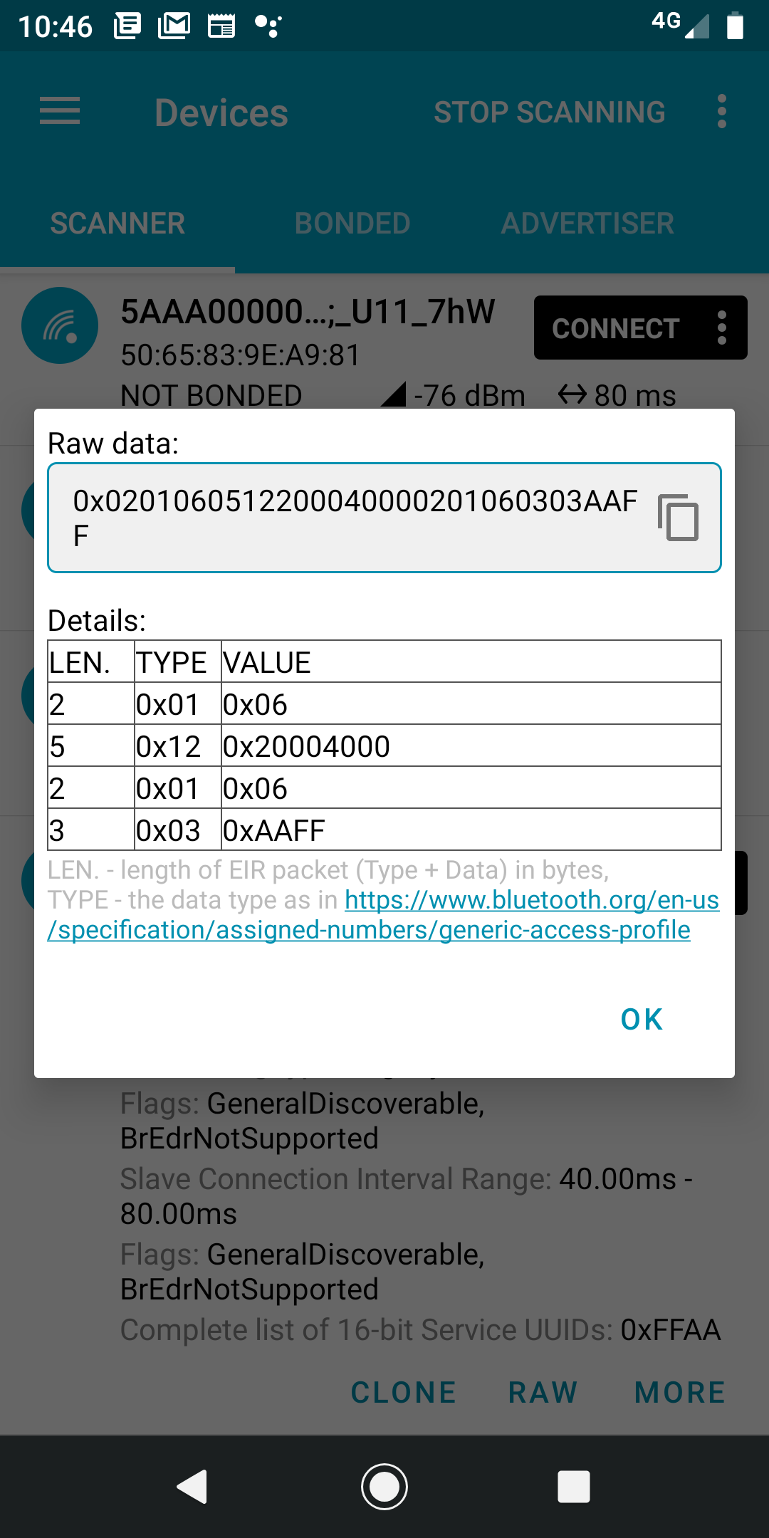

I'm designing a device with with Wi-Fi, EEPROM, GPIO functions, and also trying to make the device advertise an Eddystone URL. After I added BLEDevice, I faced Sketch too big issue. To solve that issue, I changed the default partition to increase the program memory area. I also tried selecting partition scheme "No Ota (Large APP)", the sketch size issue got solved. But the advertise data is not correct, the device advertises something else.
Attached the screenshot of the raw data captured using nRF Connect APP.
Here is the BLE (Eddystone) Initialization code:

02 01 06 03 03 AA FE 15 16 AA FE 10 00 03 62 69 74 2E 6C 79 2F 42 72 69 7A 6F 36 34 61 FF
Service Data set!

i checked your code and its data length exceeds advertising data length (31 bytes). Your advertising data length is 40 bytes.

My understanding may be wrong... but "bit.ly/Brizo64a" is 15 bytes, and beacon_data[] is loaded with 15 bytes prior to it, that comes to total 30 bytes. Am I missing something?

The problem is solved. It was mostly misunderstanding of the beacon advertisement data setting. I was doing repeated settings through the API as well as the raw data. here is the working code:
