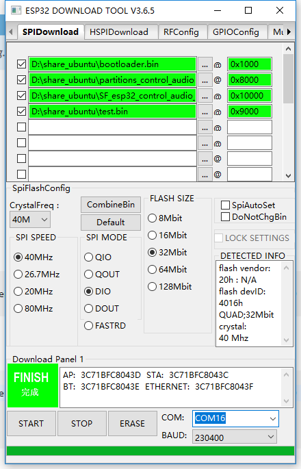

我这边是按照上面的流程进行操作
要生成的test.csv
Code: Untitled.c Select all
key,type,encoding,value
namespace_name,namespace,,
key1,data,u8,1
转.bin指令
python ~/esp/esp-idf/components/nvs_flash/nvs_partition_generator/nvs_partition_gen.py --input test.csv --output test.bin --size 0x6000
分区表也进行了修改
# Espressif ESP32 Partition Table
# Note: if you change the phy_init or app partition offset
# make sure to change the offset in Kconfig.projbuild
# Name, Type, SubType, Offset, Size, Flags
nvs, data, nvs, 0x9000, 0x6000,
phy_init, data, phy, 0xf000, 0x1000,
factory, app, factory, 0x10000, 1200000,

if the requested key doesn't exist,key值不存在,请问下我是哪一步出现问题呢?

问题找到了,把read的函数换成nvs_get_u8就好了
