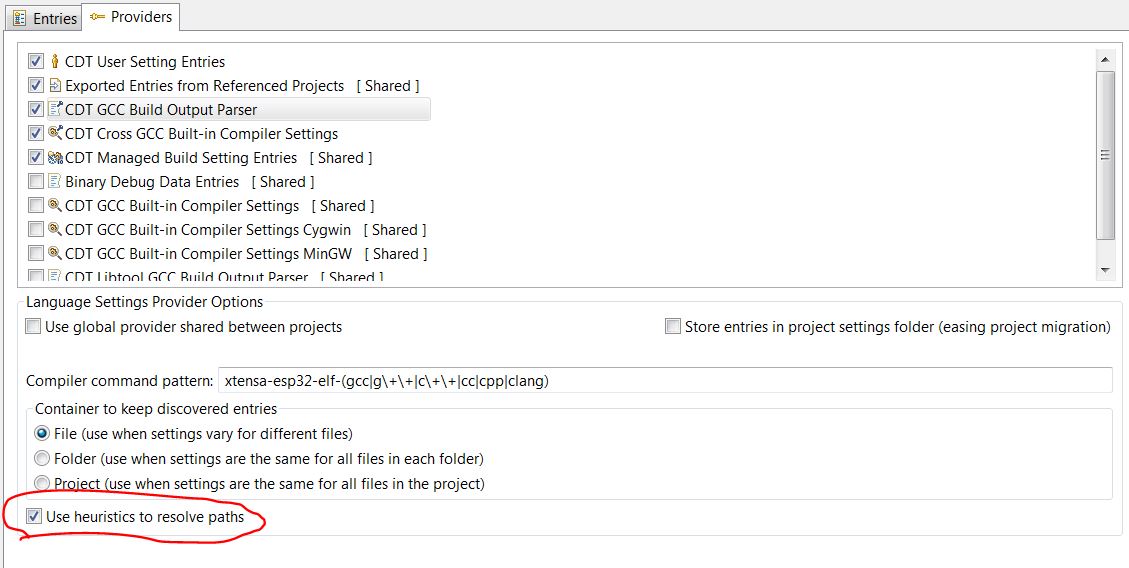

Once you get Eclipse to build successfully, the next thing to figure out is why the CDT Output parser isn't able to parse the include paths from the build output. A few points to note:
  • Does your build log contain xtensa-esp32-elf-gcc compiler calls for the parser to parse?
  • Does your project/project source files contain any CDT GCC Build Output Entries after a clean and build in Eclipse? If so, what style paths (linux/windows) are those entries in?
  • Is Use heuristics to resolve paths enabled in your CDT GCC Build Output Parser Settings?

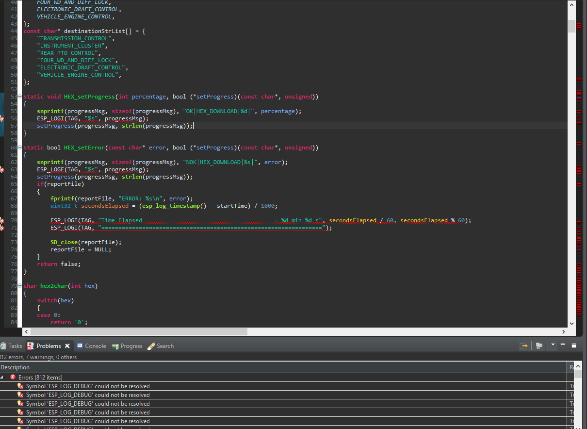

I'm still getting errors in eclipse with windows.
Mostly with defines like ESP_LOGI, ESP_SPP_MODE_CB, CAN_MODE_NORMAL etc
But builds finish successfully. Same problem occurs in more projects, and more computers. Sometimes the errors disappear, but eventually reappear

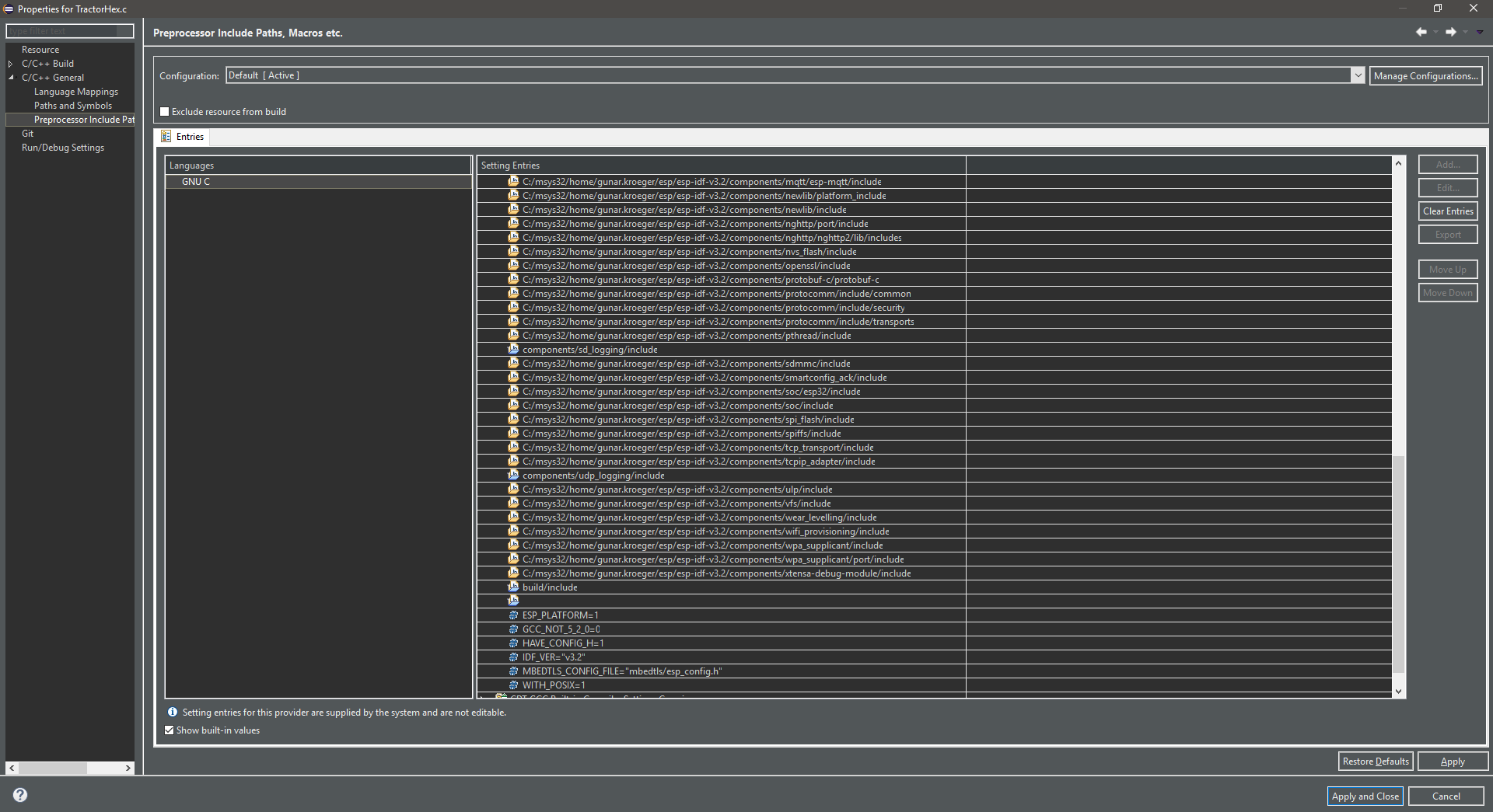

gunar.kroeger
Posts: 143
Joined: Fri Jul 27, 2018 6:48 pm
Re: Eclipse still showing "unresolved inclusion" and "Symbol couldn't be resolved"
Postby gunar.kroeger » Tue May 14, 2019 12:48 pm

I'm using Windows 10 and I recently upgraded from Eclipse Oxygen to Eclipse IDE 2019-03. Unfortunately the ESP-IDF include files were no longer found in the existing Eclipse projects.
I had to set "Allow heuristic resolution of includes" to `*ON` (which is the default in Eclipse IDE 2019-03).
And make sure to use forward slashes in the Environment Variable IDP_PATH and PATH.
Note that these settings are somewhat different than the instructions in the latest Espressif online manual.
C/C++ Build -> "Environment" properties page
	Add key BATCH_BUILD value  1
	Add key IDF_PATH    value  C:/myiot/esp/esp-idf
	Change key PATH     value  C:/msys32/mingw32/bin;C:/msys32/opt/xtensa-esp32-elf/bin;C:/msys32/usr/bin
/// ***SKIP-FOR Eclipse IDE 2019-03! Must be *ON now. ***
//  C/C++ General -> Indexer property page Do:
//      *ON  "ENable project specific settings".
//      *OFF "Allow heuristic resolution of includes"
C/C++ General -> "Preprocessor Include Paths, Macros, etc." property page -> tab "Providers"
	click "CDT GCC Build Output Parser" *ON
		Set "Compiler command pattern" :=       xtensa-esp32-elf-(gcc|g\+\+|c\+\+|cc|cpp|clang)
	click "CDT Cross GCC Built-in Compiler Settings" *ON
		Set "Command to get compiler specs" :=  xtensa-esp32-elf-gcc ${FLAGS} -std=c++11 -E -P -v -dD "${INPUTS}"
