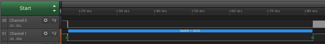

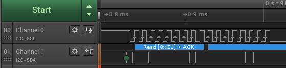

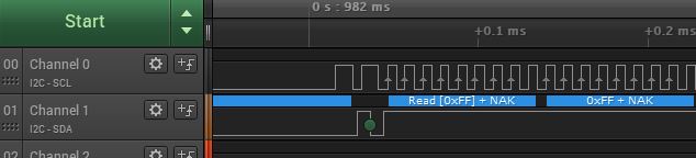

reading the first segment works, I read the expected value. but for the second, I never receive the I2c_END_DETECT_INT interrupt and it seems that the master sends a STOP when it should not.
After reading segment0, the sda line is not released, and the slave does not send the rest of the data.
what I need to add / correct for the reading to go right?

As Sarah described, when the master read operation is ongoing the SDA line is held for some reason by ESP32 master.

As you can see in the code, in segment 1 there is always a END command after each read operation.
It is done through " I2C[i2c_num]->command[g_cmd_index_use+1].op_code = I2C_CMD_END; "
What we see is the SDA line behaves erratically during the 2nd read operation of the segment 1.
