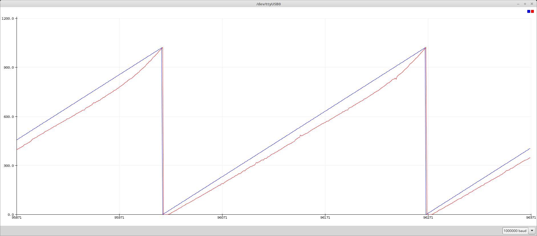

( for the images 10 bit values are used: DA>>2, AD<<2)
I got same strange results like vseven in his first post.
I wanted to put DA voltage (8bit) to pin 25 (DAC_CHANNEL_1) and then (pin 25 connected to pin 35) read back the voltage with adcStart(35),adcEnd(35); shifted from 12 bit to 8 bit.
Ideally it should give the same value but it does not: Original_Output.jpg
I think it should be possible to correct this behavior using a lookup-table: What value Corrected[x] do I have to put out to get the result x when reading back:
dac_output_voltage(DAC_CHANNEL_1, Corrected[(int)out]);

just let it run a minute and it will write a line like this:
uint16_t Corrected[256 ]= { 0, 6, 7, 8, 10, 11, 12, 13, 14, 15, 16, 17, 18, 20, 21, 22, 23, 24, 25, 26, 27, 28, 30, 31, 32, 33, 34, 35, 36, 38, 39, 40, 41, 42, 43, 44, 45, 46, 47, 48, 49, 51, 52, 53, 54, 55, 56, 57, 58, 59, 60, 61, 62, 64, 65, 66, 67, 68, 69, 70, 71, 71, 73, 74, 75, 76, 77, 78, 79, 81, 82, 83, 84, 85, 86, 87, 88, 89, 90, 91, 91, 93, 95, 96, 97, 98, 99, 100, 102, 103, 104, 105, 106, 107, 108, 109, 109, 111, 112, 113, 114, 115, 116, 118, 119, 120, 121, 122, 123, 124, 125, 126, 127, 127, 128, 129, 130, 131, 132, 133, 134, 136, 137, 138, 139, 140, 141, 142, 143, 144, 145, 146, 147, 148, 149, 151, 152, 153, 154, 155, 156, 157, 158, 159, 161, 162, 163, 164, 165, 166, 167, 168, 170, 171, 172, 173, 174, 175, 176, 177, 178, 178, 180, 181, 182, 183, 184, 185, 187, 188, 189, 190, 191, 192, 193, 194, 195, 196, 197, 198, 199, 200, 201, 202, 203, 204, 205, 206, 207, 208, 209, 210, 210, 211, 212, 213, 214, 215, 216, 217, 218, 218, 219, 220, 221, 222, 223, 224, 224, 225, 226, 227, 228, 228, 229, 230, 231, 231, 232, 232, 233, 234, 234, 235, 235, 237, 237, 238, 238, 239, 240, 240, 241, 241, 242, 243, 243, 244, 245, 245, 246, 247, 247, 248, 248, 249, 249, 250, 250, 251, 252, 252, 253, 253, 254, 255 };
Using this lookup-table I get much better results:
Remember:
This does NOT mean that the outputs and readings now are as linear as it shows in the resulting image!
For that we should build 2 different lookup tables for DA and AD Converter but I do not have such precice instruments to build them.
But for my purposes Corrrected[256] helped a lot.

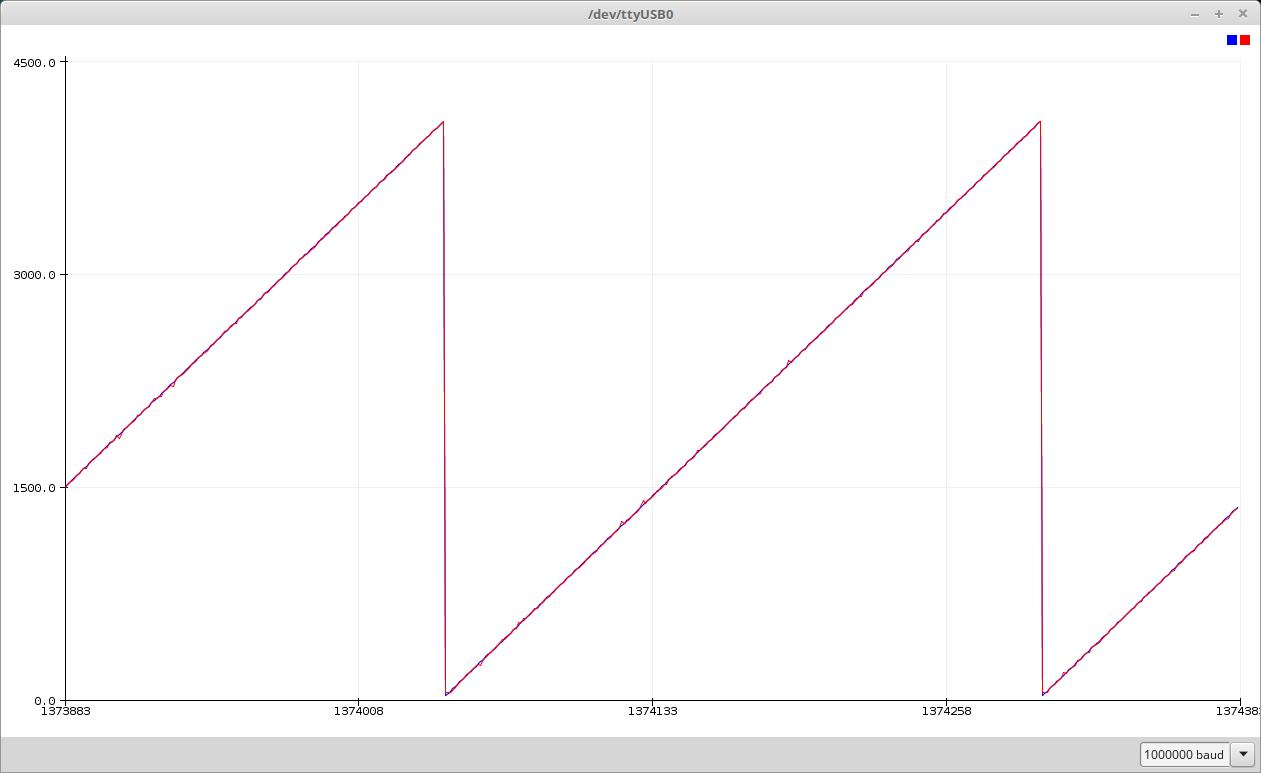

Is it possible to get precise results from ESP32-ADC ?
As told we need a LUT for that.
I could not resist to do it myself as a proof of concept :D
AND FOR ME IT WORKS VERY WELL.

Then I want to build a LUT:
1) Send a value X to DAC
2) Read back value Y from ADC. (pins 25 and 35 are connected)
3) Value Y (0..4095) mostly is too low. We need a LUT (0..4095) to correct the measured value.
4) Correct the value: Y =LUT[Y]
5) Plot the value Y which should match X now. (Attention: Y should be > about 70 !)
Because the DAC uses 8 bit I have to interpolate to get the LookUpTable 0..4095.
But the errors caused by that are much less than the usual noise.
I am really surprised how good the results are. Look at the image.
Here is the program.
How to use: (Arduino_IDE, ESP32)
1) Connect pin25 and pin 35
2) Start the program
3) Start the Serial Plotter
4) Wait some minutes - you will see garbage (from the printout of results)
5) See the corrected values as image (see below). The correction is made for YOUR ESP32.
6) Comment out #define GRAPH
7) Start the program again
8) Wait some minutes.
9) When the program stops you get 2 arrays to include in your sources:
float ADC_LUT[4096] = { .... with best precision
and
int ADC_LUT[4096] = { ... less precision, but with less memory footprint
In your source:
Y=readAnalog(); Y=ADC_LUT[Y]; (look at the program)

Here is a second program which includes the LUT of MY Esp32.
Just let it run and start Serial Plotter.
It would be interesting if someone can run it WITHOUT modification and report the results.
Then we can see the differences between different ESP32.
// (C) 2019 Helmut Weber
// use with Serial Plotter
// DO NOT FORGET TO WIRE PIN 25 WITH PIN 35 !!!

int a1;
void setup() {
    Serial.begin(921600);
    adcAttachPin(35);
    dac_output_enable(DAC_CHANNEL_1);  // pin 25
    dac_output_voltage(DAC_CHANNEL_1, 0);
// After calibrating YOUR ESP32:
// Measure
//     dac_output_voltage(DAC_CHANNEL_1, 200);
// with an external voltmeter (pin 25-ground)
// Set your measurement as
//     float My200Volt = (2.44 = your measurement, should be near by);
// at the beginning of the program
// Enable the following outcommented lines
// Test YOUR work - with Serial monitor
// Mine is:
// Should be: 2.44V   measured:   2.44
// Should be: 1.22V   measured:   1.21
// Should be: 0.61V   measured:   0.61
//    Enable to test last results:       <<<<<<<<<<<<<<<
//    // output  My200Volt
//    delay(1);
//    Serial.println("Start");
//    delay(1);
//    adcStart(35);
//    delay(1);
//    int a1 = adcEnd(35);
//    a1 = (int)ADC_LUT[a1];  // Correct the value
//    Serial.print("Should be: My200Volt(2.44)   measured:   ");
//    Serial.println((float)(a1>>4)*My200Volt/200.0,2);
//    // output 1.22 V
//    dac_output_voltage(DAC_CHANNEL_1, 100);
//    delay(1);
//    adcStart(35);
//    delay(1);
//    a1 = adcEnd(35);
//    Serial.print("Should be: My200Volt/2   measured:   ");
//    // output 0.61 V
//    dac_output_voltage(DAC_CHANNEL_1, 50);
//    delay(1);
//    adcStart(35);
//    delay(1);
//    a1 = adcEnd(35);
//    Serial.print("Should be: My200Volt/4   measured:   ");
//    Serial.println("\npress Reset Button to repeat\n");
//    while(1);
void loop() {
  for (int i=5;i<256;i++) {
      dac_output_voltage(DAC_CHANNEL_1, (i) & 0xff);
      adcStart(35);
      delayMicroseconds(200);
      a1 = adcEnd(35);
      Serial.print(i*16); Serial.print(" "); Serial.println(a1);
Fast is not fast enough :D
