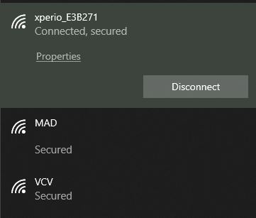

On execution the AP created ( client credentials passed) have a newline character at the end. How to remove the newline character from the end of the string?

Postby boarchuz » Wed Sep 04, 2019 8:18 pm
file.println
file.print

Postby lbernstone » Thu Sep 05, 2019 1:14 am
s.trim();
p.trim();
