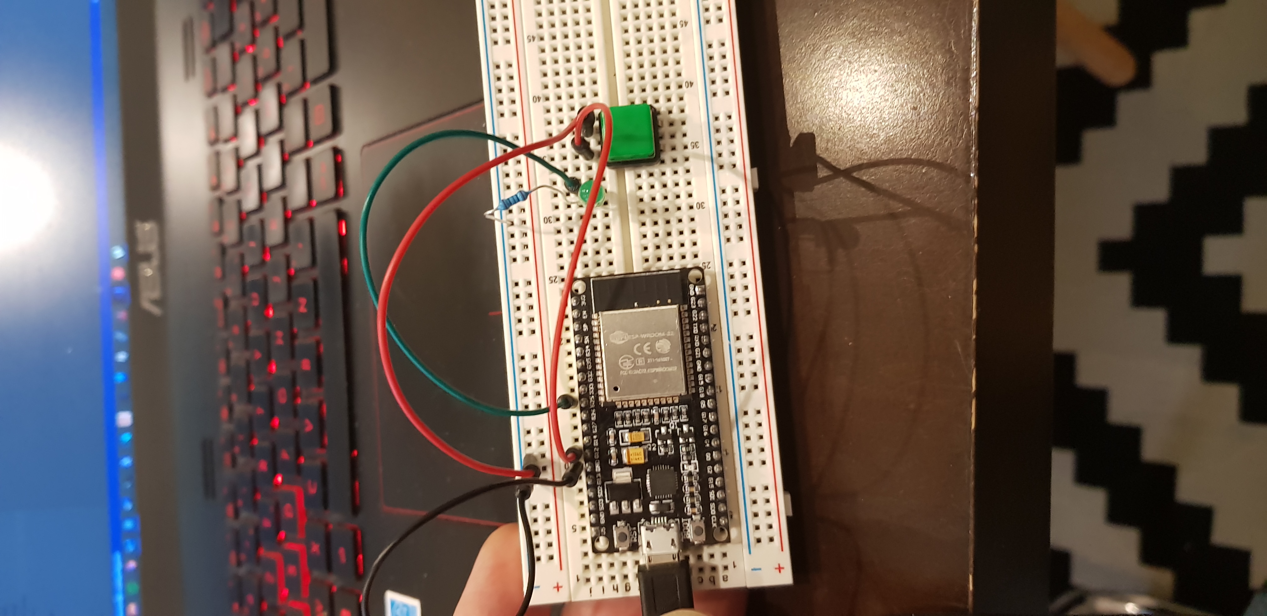

Sorry to ask basic things but, I tried this code:

If I set GPIO_PULLDOWN_DISABLE, I have bounces.
Since I set GPIO_PULLDOWN_ENABLE, the interruption is not called and the button does not work.
I do not understand.

How is your button wired up ?

Postby oliverbru » Fri Sep 27, 2019 11:00 pm
I attached the image.

Thanks, however there is no way i can tell by the photo. Does your button have a pullup resistor? It does not look like it.,

The button is connected to ground and the pulldown is connected to ground so all you will get is ground
