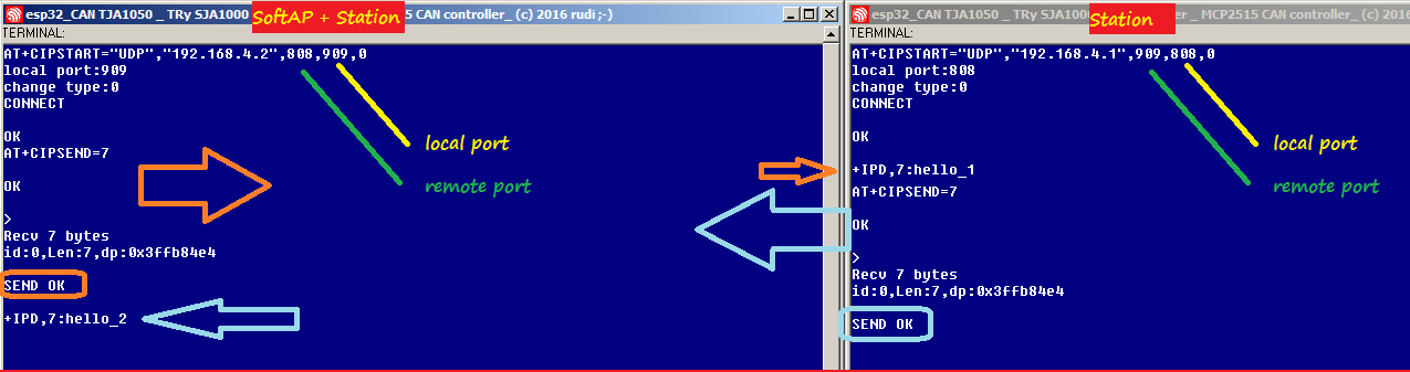

// now remember you, SoftAP/SVR port (909) , Station/Client Port (808) and UDP
// so simple start a "UDP" network on your StationAP, local port is 909, and remote(client side) port will be 808
// the ip address you must use from the client, usually StationAP is 192.168.4.1 and the client becomes 192.168.4.2
// you must check it
// the last parameter is "do not change the ports after close, and reconnect"
// note: in UDP you must give the first port parameter for the remote, the second is for local
// so for SoftAP (909) is valid
AT+CIPSTART="UDP","192.168.4.2",808,909,0
// your "UDP" (server) network is ready on StationAP side
// now Station
// Station Mode ..
AT+CWMODE=1
// join to SoftAP
AT+CWJAP="pawelnetwork","not4uPassort"
// you can check your client IP
// usually comes the next after the SoftAP Ip ( 192.168.4.1 ...192.168.4.2 ...192.168.4.3 and so on )
AT+CIFSR
+CIFSR:STAIP,"192.168.4.2"
+CIFSR:STAMAC,"18:fe:34:2c:d8:d0"
// set up your client for the "UDP" network
// so simple start a "UDP" network on your Sation (client), local port is 808, and remote(SoftAP, "Server" side) port will be 908
// the ip address you must use from the SoftAP, usually is 192.168.4.1 ..
// and here same
// so for Station (808) is valid
AT+CIPSTART="UDP","192.168.4.1",909,808,0
// your "UDP" (server) network is ready on Station ( client ) side
// now you can start
// if you want start first to try one message to the other so try on SoftAP
// you use single connection so set it:
AT+CIPMUX=0
// now send 7 chars
AT+CIPSEND=7
hello_1
// now you have send from SoftAP to the Station, you must see on Station Terminal your message
// now send from Station to SoftAP
// single connection
AT+CIPMUX=0
// now send 7 chars
AT+CIPSEND=7
hello_2
// now you have send from Station to the SoftAP, you must see on SoftAP Terminal your message

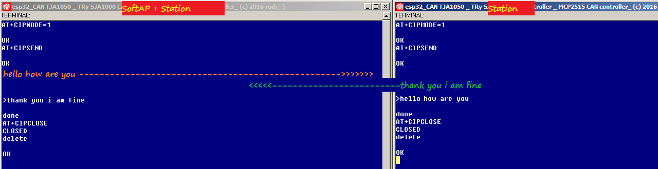

// now start transparent mode on each side
// each character you send from one you will see in the other
// SoftAP
AT+CIPMODE=1
// Station
AT+CIPMODE=1
// SoftAP
// now push your data to Station bidirectional
// each char you put you send to the connected esp
// Station
// now push your data to SoftAP bidirectional
// you stop the transmission by sending "+++"
// you must do this without delays and spaces and CR and LF
esp_at_port_write_data( (uint8_t *) "+++", strlen("+++"));

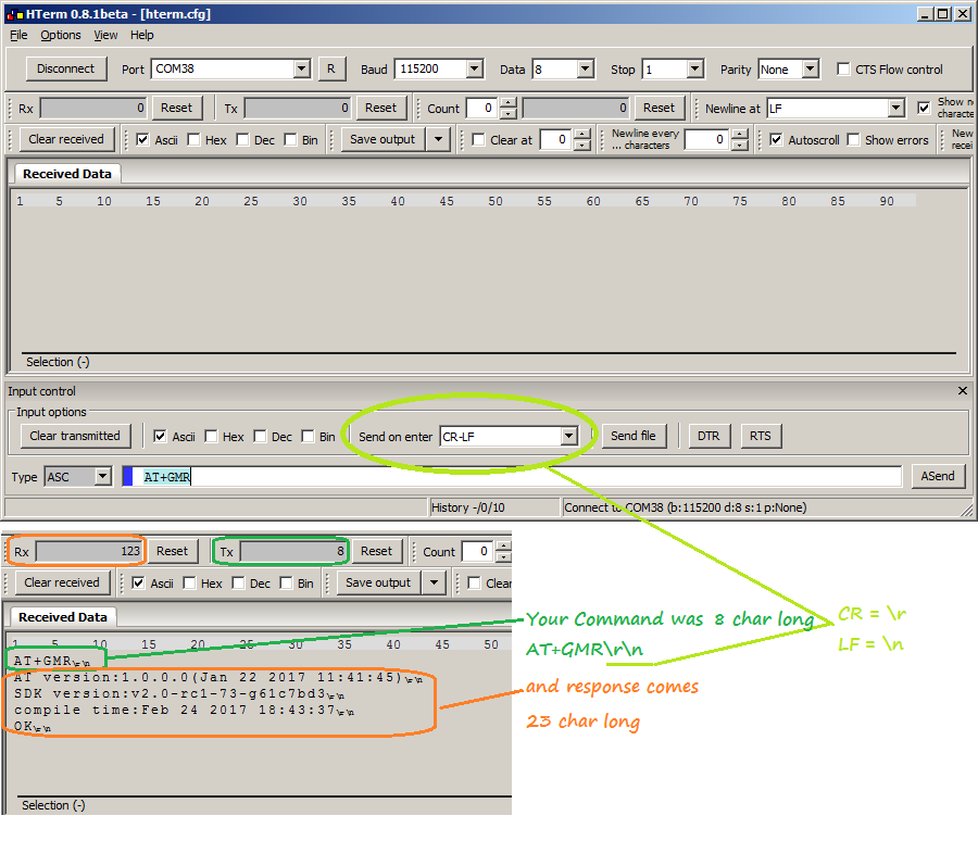

hi pawel
if you not trust DATA Packet sends/received
things further for your way, if you not have know:
UDP is fast - but not sure, that all data packets send/received
and they are not sorted, it can be, that a packet you send before a next packet
received later as the next packet.
you can use own increment ID for each packet and build on receiver site at this increments your data
if one is wrong or missed, you can send back that sender must send again and so on...
but then UDP is not fast.. ( this work do TCP auto..)
TCP is small slower, but if data packets hang or not successfull send/received
there is auto controll for this in the TCP protokoll, and the packets are incremented in right structure ( First in Firt out )

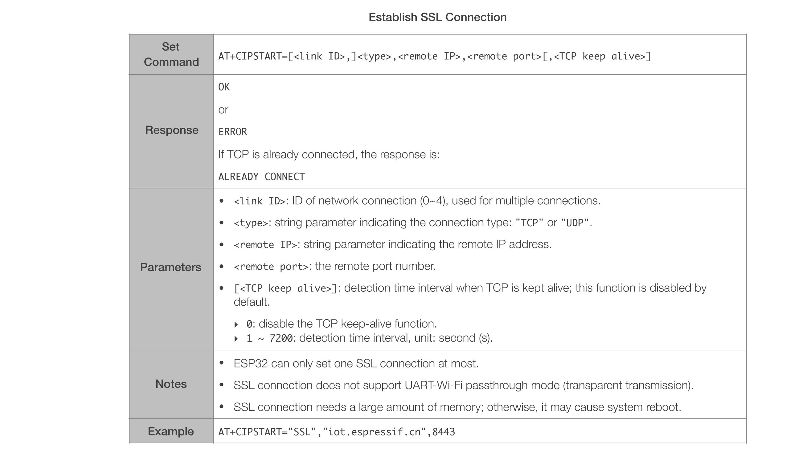

"UDP" vs. "TCP"
if you have problems with SoftAP WEP/WPA/WPA2, you can try for first steps an Open Network
if communication then stable, you can try step by step to go on for secure Network and change open to encrypted..hidden
next step you can then use not UDP, not TCP, you can try a SSL connection too.
( from myself not tested just in time )
AT+CIPSTART Establishes TCP connection, UDP transmission or SSL connection.
have phun!

Hi Luca,
Component Config -> AT (using a usb-serial adapter)
*uart port number for AT command = 1
*uart rx pin for AT command = 16
*uart tx pin for AT command = 17
have you switched your usb serial adapter to 3.3V?
have you connected cross?
ESP32(uart rx -> usb-serial adapter(uart tx pin)
ESP32(uart tx -> usb-serial adapter(uart rx pin)
and have you connect
ESP32(GND) -> usb-serial adapter ( GND)
also i tried with
also with no result. With no result, i mean that i send command with no reply from the esp
ok, no reply from esp,
do you see the boot message in your terminal?
see you the ready
which terminal program you use?
after send command, example
AT+GMR
the send command must followed by return \r and newline \n character
hope this helps
