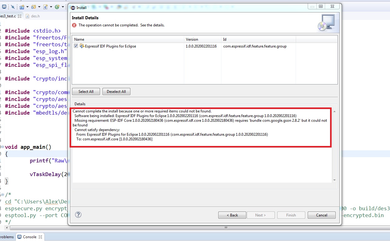

We are very sorry for the inconvenience caused.
Looks like the issue is caused by the Eclipse version - Could you make sure you have got the Eclipse 2018-12 CDT and above
https://github.com/espressif/idf-eclips ... requisites
Please provide the eclipse environment information to check further on this. Please copy and paste the entire config information and attach here.
Help > About Eclipse >Installation Details > Configuration

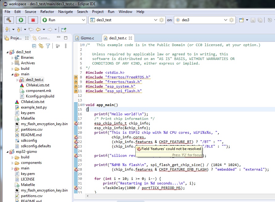

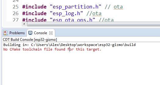

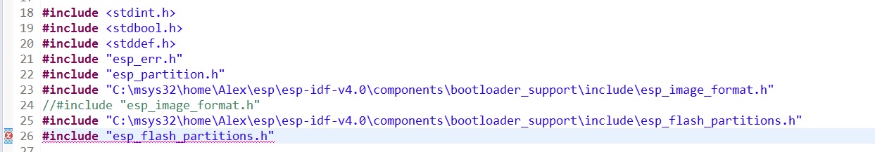

Thank you , installing Eclipse 12-2018 helped. I was able to open my project from v3. 2. 2 But there are problems with include. Files are visible , but errors appear during compilation.

And finally the final chord, after restarting the Eclipse nothing else works. It's probably time to go back to v3. 2. 2. At least through the ass, but everything worked. :lol:
