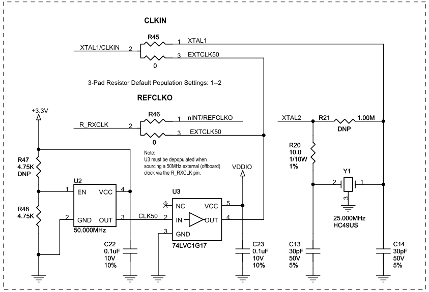

Success on LAN8720 as well. Lack of CRS/DV was due to non-populated resister R10 on the eval board which is inline between phy and CRS pin on rmii connector. Once I populated that resister, it all just worked.

just in time with LAN8720 there is a 50 MHz clk on board.
on tlk110 eval board from TI there is a 25 MHz on Board ( MII )
to use the tlk110 board with RMII we must change the onboard clk to 50 MHz
i would really much more work on GPIO16 and get from this the clk sig

Hi Rudi. The 50MHz oscillator on the lan8720 eval board is there but not used. The onboard 25MHz crystal is used and the 8720 has the functionality to double the clock for it's reference and output so that a cheap crystal can be used.
I did have to remove the 25MHz crystal and add a 50MHz oscillator to the tlk110 eval board.
Robin
hi robin

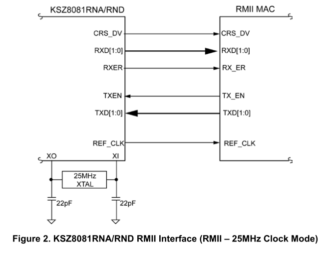

studdy just in time the same theme with further eth phy
there is the same functionally there, the 50 MHz would activate by register and the ref clk 50MHz comes :mrgreen:
i think - so we need the generated clk by gpio16 not - and we can use the 25 MHz clk.
just in time studdy and compare datasheets from more eth phys
do you know KSZ8081RNAZA ?

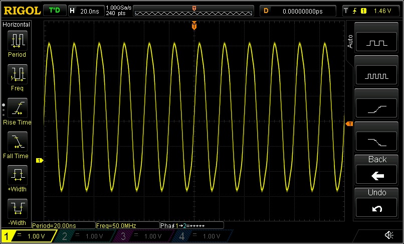

now we try to clk the RMII over the gpio16
gpio 16 has now 50 MHz refere´r
bingo !

Very cool Rudi. How are you generating the clock?
Posts: 1756
Re: EMAC receive not working
Postby rudi ;-) » Tue Feb 28, 2017 10:45 pm
hi robin
try this:
#include "soc/emac_ex_reg.h"
extern void rtc_plla_ena(bool ena, uint32_t sdm0, uint32_t sdm1, uint32_t sdm2, uint32_t o_div);
PIN_FUNC_SELECT(PERIPHS_IO_MUX_GPIO16_U, FUNC_GPIO16_EMAC_CLK_OUT);
REG_SET_FIELD(EMAC_EX_CLKOUT_CONF_REG, EMAC_EX_CLK_OUT_H_DIV_NUM, 0);
REG_SET_FIELD(EMAC_EX_CLKOUT_CONF_REG, EMAC_EX_CLK_OUT_DIV_NUM, 0);
REG_CLR_BIT(EMAC_EX_CLK_CTRL_REG, EMAC_EX_EXT_OSC_EN);
REG_SET_BIT(EMAC_EX_CLK_CTRL_REG, EMAC_EX_INT_OSC_EN);
think there is a small mistake in the params
but try this:
// f_out = f_xtal * (sdm2 + 4) / (2 * (o_div + 2))
//   = 40.000.000,00 *  (1 + 4) / (2 * ( 0 + 2) )
//   = 40.000.000,00 *  ( 5) / (2 * ( 2) )
//   = 40.000.000,00 *  ( 5) / (4 )
//   = 200.000.000,00  / ( 4 )
//   = 50.000.000,00
//   = 50 MHz
// param0= ena
// param1=smd2
// param2=o_div
// param3=?
// param4=?
rtc_plla_ena(1, 1, 0, 0, 0); // 50 MHz
// rtc_plla_ena(1, 5, 1, 0, 0); // 60 MHz
// rtc_plla_ena(1, 0, 2, 0, 0); //  20 MHz ( glass clear)
