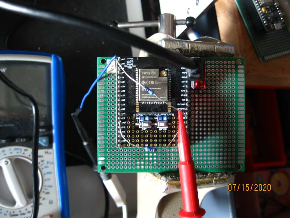

Hello
I have a ESP32 Himalaya Board and
I tried everything. I drive IO0 to Ground I let GPIO2 float I drove it down to GND
I use an External 3V3 nothing
When I push Reset I get

See attachment
Any Idea

I found this https://esp32.com/viewtopic.php?t=8704
My Problem is the Part I have to press Reset and Boot then you have to release Reset and then Boot then it works
