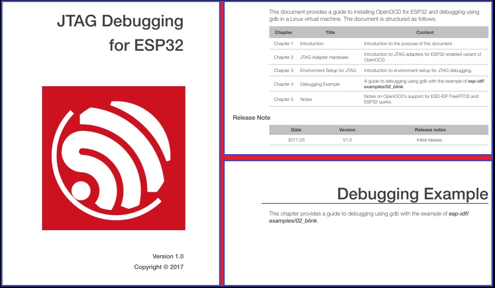

Postby rudi ;-) » Sat Mar 04, 2017 10:18 am
hi guys,
thanks for the great work on it.
JTAG Debugging for ESP32
V 1.0
2017 March 1
PDF
This document provides a guide to installing OpenOCD for ESP32 and debugging using gdb in a Linux virtual machine.
it comes with a debugging example.
please visit allways espressif ESP32 document resource for newer update or new guide's
