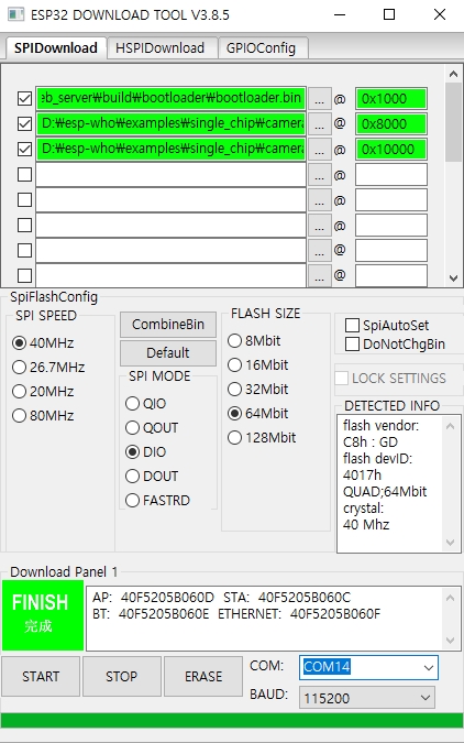

I have board rebooting problem while allocating frame buffer in PSRAM for OV5640 camera.
Any guide for me to fix this problem?

2. Logging Camera-webserver-demo with my custom board which use esp32-wrover-e module (Booting Failed)

Guru Meditation Error: Core  0 panic'ed (LoadProhibited). Exception was unhandled.
Core 0 register dump:
PC      : 0x4009141c  PS      : 0x00060330  A0      : 0x80084470  A1      : 0x3ffc0080
A2      : 0x3f800000  A3      : 0x000f0000  A4      : 0x00000000  A5      : 0x0000000c
A6      : 0x0000001f  A7      : 0x00000001  A8      : 0x00000000  A9      : 0xffffffff
A10     : 0x3f800010  A11     : 0xffffffff  A12     : 0x3f800014  A13     : 0x00000000
A14     : 0x00000044  A15     : 0x3ffbff30  SAR     : 0x00000004  EXCCAUSE: 0x0000001c
EXCVADDR: 0xffffffff  LBEG    : 0x4008b3c9  LEND    : 0x4008b3d9  LCOUNT  : 0xfffffffe
ELF file SHA256: 8674791e2127d7d9
Backtrace: 0x40091419:0x3ffc0080 0x4008446d:0x3ffc00a0 0x4008469a:0x3ffc00c0 0x400e213e:0x3ffc00e0 0x400e299d:0x3ffc0110 0x400e2d11:0x3ffc0140 0x400d94a1:0x3ffc0170 0x400d8ff6:0x3ffc0220 0x400d31c0:0x3ffc0240 0x4008d789:0x3ffc0260
Rebooting...

Postby Sprite » Tue Jan 12, 2021 2:40 am
That is strange... can you decode that backtrace? Is the firmware 100% the same on both boards, or did you need to change things because e.g. different board layouts?
Rebooting...
ets Jul 29 2019 12:21:46
This error arises due to the allocation of the buffer on the psRam. Please provide the menu configuration for the spiRam.
Also I read somewhere that the some board throw the error when there is no enough power supply to them. It seems that it has been powered by the computer/ laptop. Try to connect to the 5v stable power supply.
Thanks!
I think Flash memory size and OV5640 camera interface is different.
