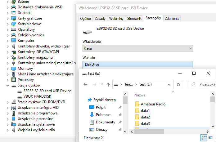

Its hard to say if its problem with cable or with OS. I am working on ubuntu, so sd card example works fine, pretty slow, but works. In other hand i tested yesterday on windows 10 virtualbox VM and there was issue in OS layer, which was resetting device every few seconds due to slow response (just guessing reason).

Sorry to hear you have so many issues with library and sd card example. There is for sure space to improve it.
I can only say that it works more or less, no problem to detect disc, no problem to read/write/modify files (tested on VM):
There is couple difference between S2 and regular sd card adapters:
- it is very slow,
- there is no option to detect sd card inserted.
Yes, i do have it too and will try to fix it eventually."There's a problem with this drive. Scan the drive now a fix
it."
- it is very slow,
