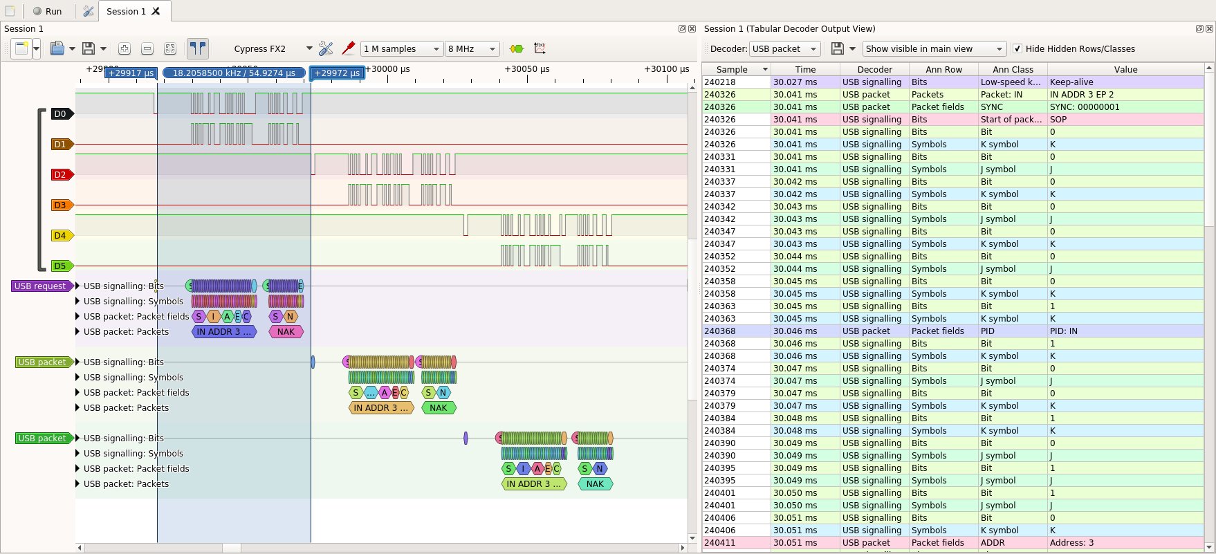

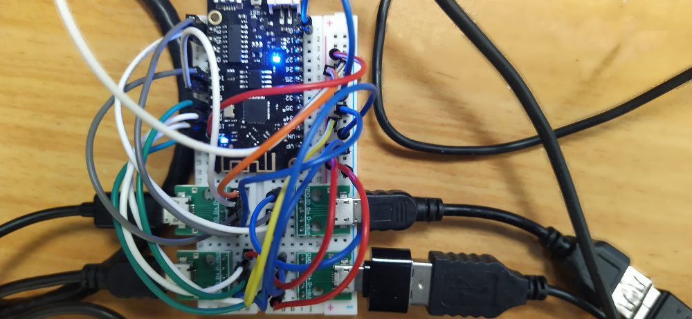

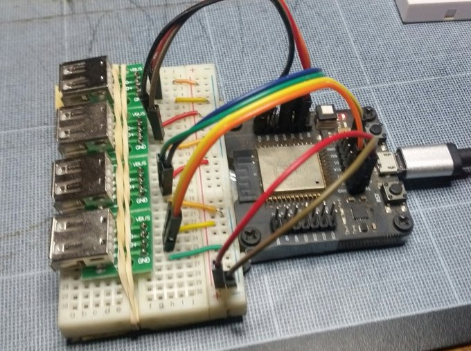

from now you can use USB-OTG by SOFTWARE on an ESP32.
ESP32 can do usb-soft-host, it's still limited to some HID classes but very promising
it is based on GPIO and the timer in this projects.
details:
ESP32 software USB host through general IO pins. We can connect up to 4 USB-LS HID (keyboard mouse joystick) devices simultaneously.
you find the work for ESP-IDF here
and you find the Arduino wrapp there
