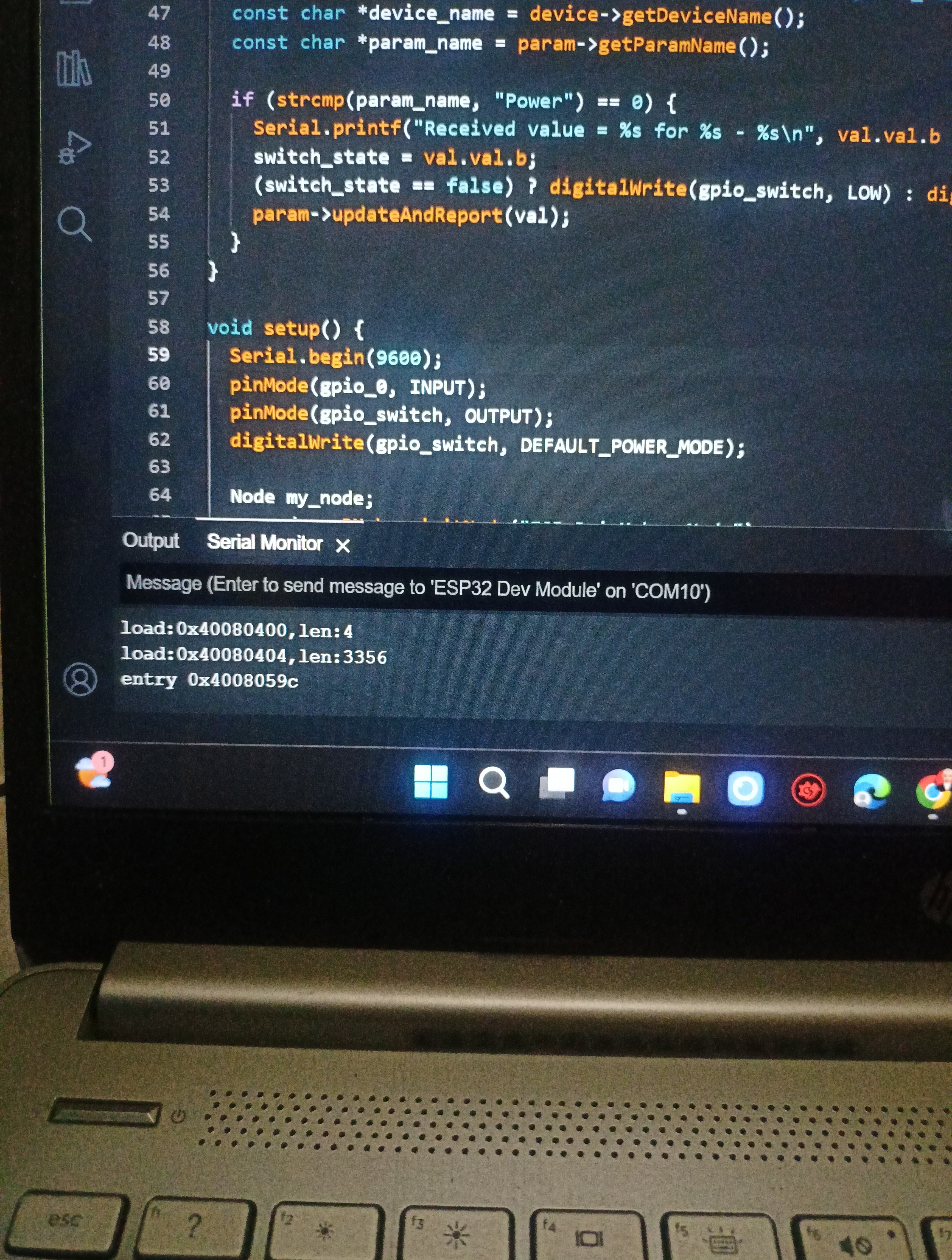

Baruna1221
Joined: Mon Jun 03, 2024 9:55 am
Re: This problem is about the Arduino-ESP32 Rainmaker demo
Postby Baruna1221 » Mon Jun 03, 2024 10:02 am
Why my serial monitor in arduino ide cannot display qrcode? I already install library esp32, etc
This is my serial monitor in arduino ide
