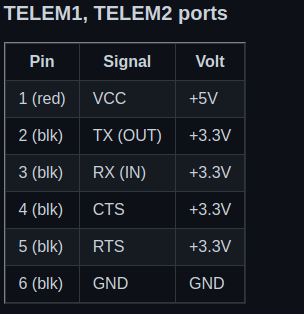

I am struggling to connect to an ESP32-Wrover-B's softAP.
I have PIN 17 and PIN 19 acting as TX, respectively as RX. They are connected to a CubeOrange flight controller as I am trying to establish a serial communication.
And whenever they are connected, the softAP won't assign an IP address to the device that I am trying to connect with.
But, it works properly when I do not have any GPIO connections.
The drone Serial Port has 3v3 signals: https://github.com/ArduPilot/ardupilot/ ... /CubeBlack
I am using PIN17 and PIN19 as they are labeled on the board.
In code they are written as GPIO_NUM_17 and GPIO_NUM_19.
First question: are they the same on the Wrover ? Is PIN17 the same as GPIO17 ? The same with 19.
I am asking this because I have tried using PIN16(as labeled on the board) as GPIO_NUM_16 an it did not work.
Second question: can the GPIOs state affect WiFi in some way ?
softAP starts and then stops without giving the device that I am trying to connect with an IP address.

Hello @GeorgeFlorian1
the ESP32 Wrover-B module has PSRAM, which requires GPIO 16 and 17 so you cannot use those for anything else.

I've moved to GPIO 18 and 19. These are connected to the drones RX and TX pins respectively. The measured voltages on these pins is 3v3.
I am powering the ESP using the USB from the PC.
Whenever I power up the drone, the ESP won't assign an IP to the device that's trying to connect to the softAP.

Whenever I have the GPIOs (18,19,21,22) acting as RX and TX and connected to the Flight Controller the ESP doesn't assign IP Addresses.
I have enabled Verbose logs and I've posted them here: https://github.com/espressif/esp-idf/issues/7268
There doesn't appear to be any errors. On the other hand, I am not skilled in reading them.

Postby Sprite » Wed Jul 14, 2021 12:59 am
I'm idly wondering if the flight controller possibly outputs EMC on these lines, interfering with the ESP32s WiFi capability... Could you e.g. add a small capacitor (2.2pF or so) to ground on these lines, see if that makes a difference?
