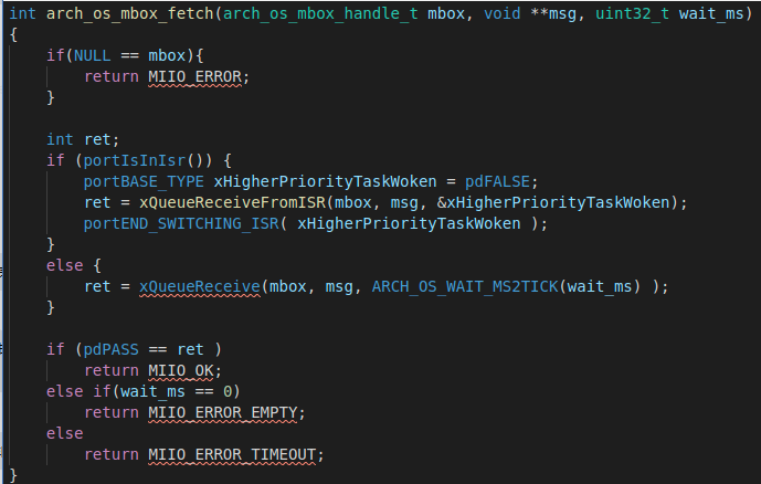

Using backtrace, I traced the code to the following.
This code is just a loop waiting for the data, which is triggered by the mbedTLS to read the data.
So my question is why backtrace prints these information. If according to your condition of triggering the interrupt watchdog, I don't think it should print this task, because context switch has been prohibited.

Can't answer about the backtrace, but the problem is probably the xQueueReceiveFromISR. This function is meant to receive data inside the ISR, and not from one ISR.
Best regards.
Posts: 10645
Re: How to debug ESP32interrupt watchdog timeout
Postby Sprite » Tue Aug 10, 2021 1:19 am
Disagree, that bit of code is only called if the entire function is called form an ISR (portIsInISR). Additionally, I don't think there's anything wrong with calling *FromISR functions in a non-ISR situation, you just don't get to do any blocking.

arch_os_mbox_fetch function is not called inside an interrupt callback, which is where I get confused.
In my understanding, if not disable interrupt, then the watchdog must be in the ISR function infinite loop when triggered, should be obvious from the backtrace.

To be honest, it's hard to guess from the backtrace alone, but it smells like memory corruption, or something like use-after-free... the top function called is vListInsert, which tends to run in a critical region. If the list that needs inserting into is somehow corrupted, that function could possibly loop forever trying to find the insertion point. It's far from a smoking gun here, but you could see what happens if you enable the various memory debugging options in ESP-IDF.
