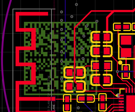

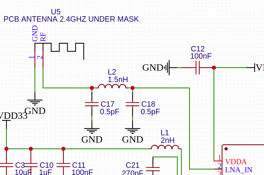

Help need, I made custom PCB using ESP32 bare chip in which I am facing issue in Bluetooth range

You did proper RF design and matching or just hoped for the best?

It will help if you provide some more details about like:
Antenna layout/type
Antenna matching circuit (as mentioned before)
Schematic
Some PCB pictures
PCB layout (keep out zones) and stack-up
Case type (if applicable)
This is a typical issue in designs using the bare SoC without a proper antenna selection and matching circuit.

Re: Help need, I made custom PCB using ESP32 bare chip in which I am facing issue in Bluetooth range
Below is screenshot of schematicand pcb layout
There are so many different issues you can find in RF designs.
As ESP_LJH said, send your files to our sales team and they will help to review your design.
Some of the common mistakes in RF designs are regarding the 50R impedance line (including trace thickness), matching circuit not tuned, traces/planes/components behind the antenna and many others.
It's hard to say the issue root cause without testing and checking if your antenna tuning was done correctly.
