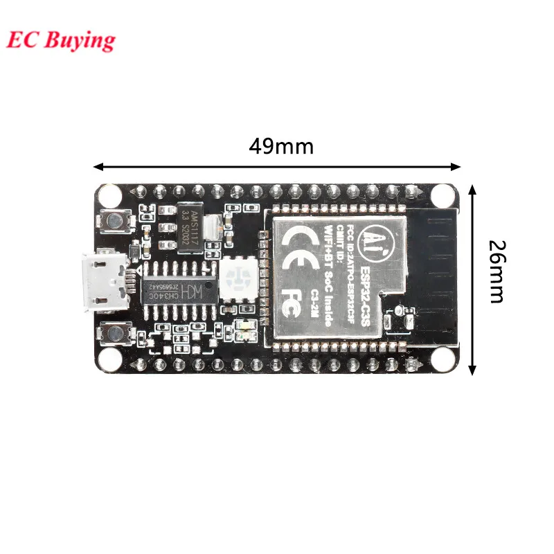

khoih-prog
Posts: 53
Joined: Sat Feb 22, 2020 8:16 pm
Re: esp32c3 arduino ide my code is not executed
Postby khoih-prog » Tue Aug 24, 2021 5:17 pm
I'm using Python 2.7.18 (default, Mar 8 2021, 13:02:45) and esptool_py v3.1.0 and the following is the Arduino IDE uploading commands

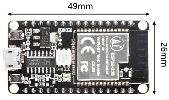

It's possible some bug of Arduino esp32 core as it's still OK with esp-idf.
I'm afraid this issue is board dependent and will order some different boards to try and see.
The current board is Image
and ordered from https://www.aliexpress.com/item/1005002783695684.html
