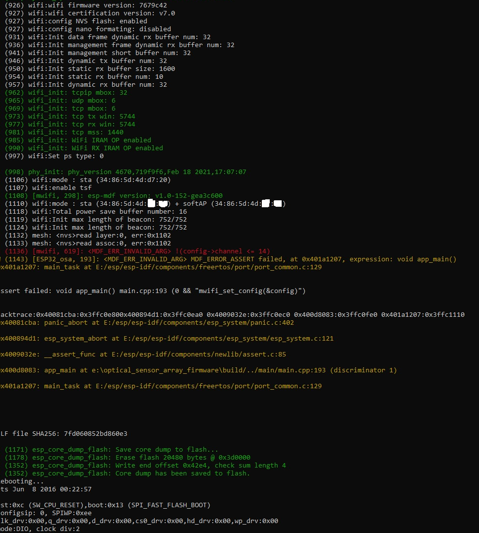

I have running code but for some time now adding new line of code (e.g. MDF_LOGI or watchdog) causes problem with initialization of program when I load wifi configuration, ... etc. from NVS.
I needed to add watchdogs to both tasks.
I guess its a problem with memory because I changed one task from dynamic to static and it works fine again.
So I have 3 cases:
1. Adding watchdog to one task - WORKS
xTaskCreate(communication_task, "communication_task", 4 * 1024, NULL, 6, NULL);
xTaskCreate(VL53L0X_task, "VL53L0X_task", 4 * 1024, NULL, 4, &xHandle_VL53L0X);
MDF_ERROR_ASSERT( esp_task_wdt_init(100,1) );
MDF_ERROR_ASSERT( esp_task_wdt_add(xHandle_VL53L0X) );
2. Adding watchdog to second task - DOESN'T WORK (compiles but fails during initialization from NVS)
xTaskCreate(communication_task, "communication_task", 2 * 1024, NULL, 6, &xHandle_communication);
MDF_ERROR_ASSERT( esp_task_wdt_add(xHandle_communication) );
3. Adding watchdog to second task and changing it to static- WORKS AGAIN (compiles but fails during initialization from NVS)
xHandle_communication = xTaskCreateStatic(
                communication_task,
                4 * 1024,
                ( void * ) 1,
                6,
                xStack,
                &xTaskBuffer );
Is it a problem with memory? If so which memory is responislble for that and how can I check it?
Thanks in advance and best regards,
Mateusz

1. How does it fail?
2. 4K is a very low amount of stack you're allocating. Try to increase that, see if it fixes things.
1. Those are logs from monitor, the error is in wifi initialization function. But during debuging, the error appeard on earlier stage of program, so I guess it isn't the cause
error msg.png (704.74 KiB) Viewed 2310 times
Main function wifi initialization is befor starting my tasks.

    MDF_ERROR_ASSERT(wifi_init());		///////////PROGRAM FAILES SOMEWHERE HERE

2. I guess I tried to increase the stack before. Tomorrow I will have access to the device and will try again.
