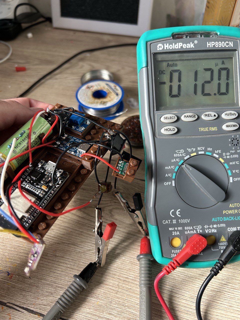

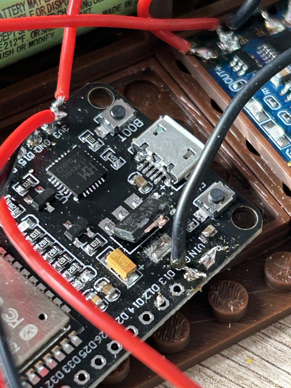

ivan0307
Joined: Sat Jan 31, 2026 10:07 am
Re: Power Consumption in Deep Sleep
Postby ivan0307 » Sat Jan 31, 2026 10:12 am
I'm using Esp32DevkitV1 (with AMS1117), and it was consuming ~4ma in deep sleep. After cutting-of off AMS1777 (enough to cut big leg) - consumption has dropped to ~12 microampers. Powered via 3.3V pin directly from 18650 battery.
