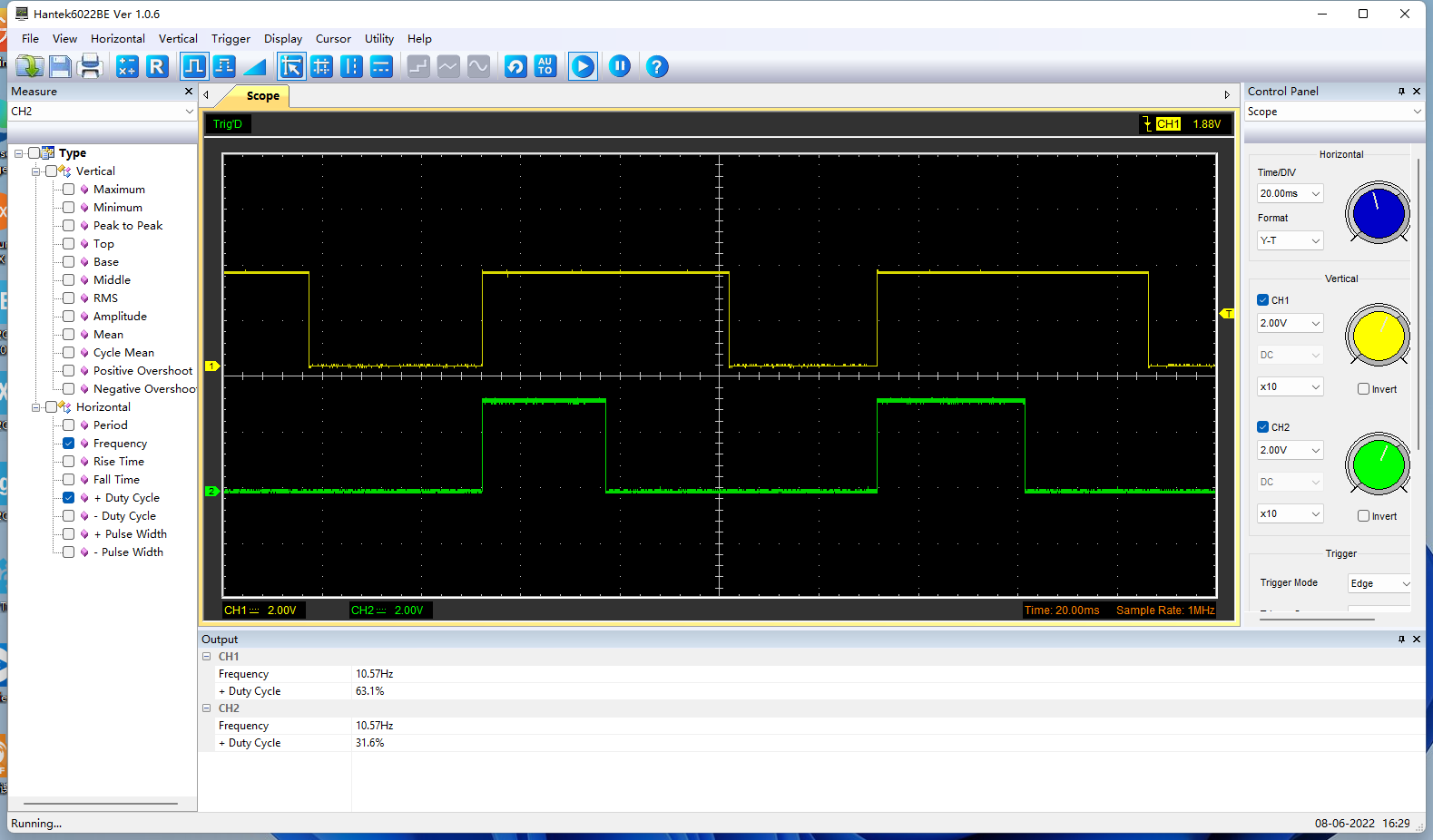

关于在使用esp内部MCPWM模块时,测试发现设置频率位1000,然后读出频率也为1000,但是示波器测出来只有10hz

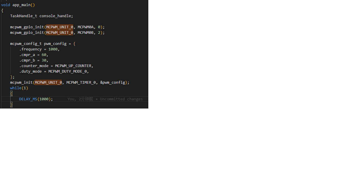

I can get the 1KHz waveforms without issue with the following code snippet
* SPDX-FileCopyrightText: 2010-2022 Espressif Systems (Shanghai) CO LTD
* SPDX-License-Identifier: CC0-1.0
#include <stdio.h>
#include "sdkconfig.h"
#include "freertos/task.h"
#include "driver/mcpwm.h"
void app_main(void)
mcpwm_gpio_init(MCPWM_UNIT_0, MCPWM0A, 0);
mcpwm_gpio_init(MCPWM_UNIT_0, MCPWM0B, 2);
mcpwm_config_t pwm_config = {
.frequency = 1000,
.cmpr_a = 60,
.cmpr_b = 30,
.counter_mode = MCPWM_UP_COUNTER,
.duty_mode = MCPWM_DUTY_MODE_0,
mcpwm_init(MCPWM_UNIT_0, MCPWM_TIMER_0, &pwm_config);

thanks,but for the same code,the issue is not fixed yet.
is there any configuration for the time with 'sdkconfig'?

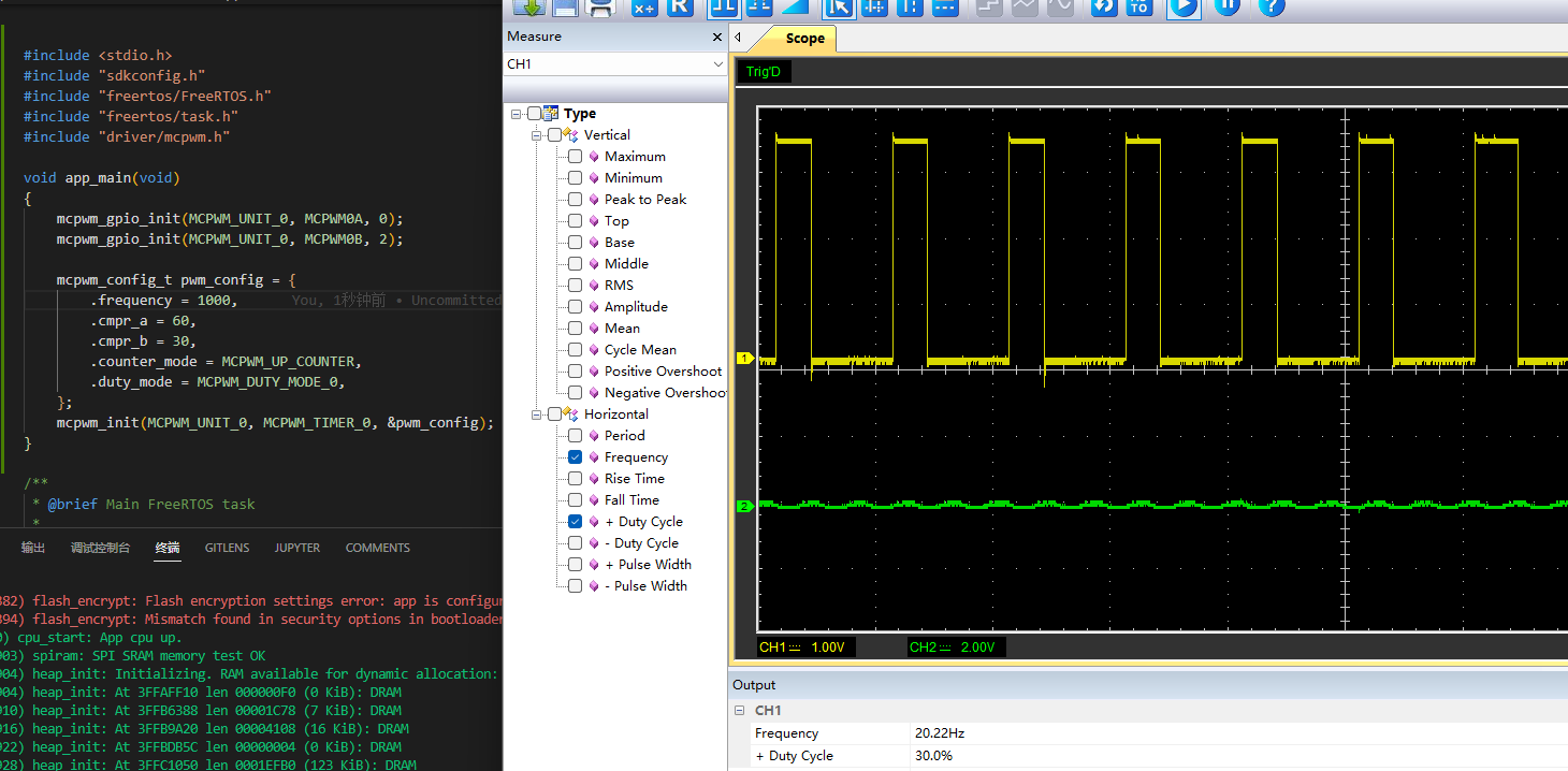

the pwm module can't work correctly with our project, but this demo can be run with default sdkconfig.
so, i think is there anything wrong with our configuration.

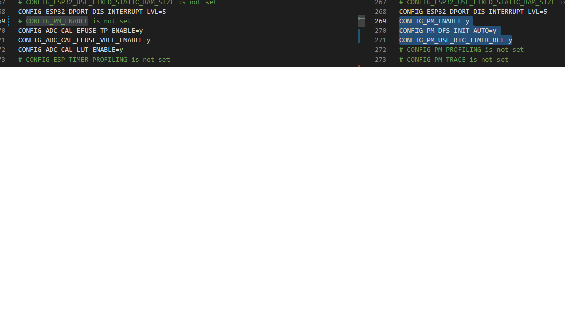

this is our project's sdkconfig file, and i don't know what the config can cause this issue.

CONFIG_PM_ENABLE=y
CONFIG_PM_DFS_INIT_AUTO=y
CONFIG_PM_USE_RTC_TIMER_REF=y

CONFIG_PM_ENABLE=y

maybe i have found the reason.
for the same environment, the same code, the same idf version, if i enable the PM CONFIG the board will work wrong.
such like the picture, the left can work correctly and the right can't.
i want to know why the PM module can cause the issue.
- 无标题.png (21.01 KiB) Viewed 7419 times
Re: MCPWM
Nice catch! You got the point. In fact the MCPWM's clock source is from an internal PLL, which is 160MHz by default. But when you enabled the Power Management, the clock frequency will be reduced to save the power if the following conditions are met:
1. CPU goes into IDLE task
2. There's no power management lock that is required by others
See https://docs.espressif.com/projects/esp ... ement.html for more information.
