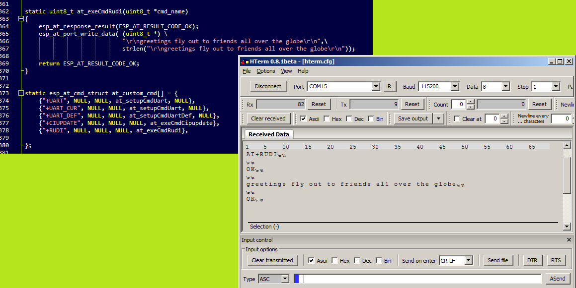

https://github.com/espressif/esp32-at/b ... ask.c#L363
fast and dirty custom at :mrgreen:

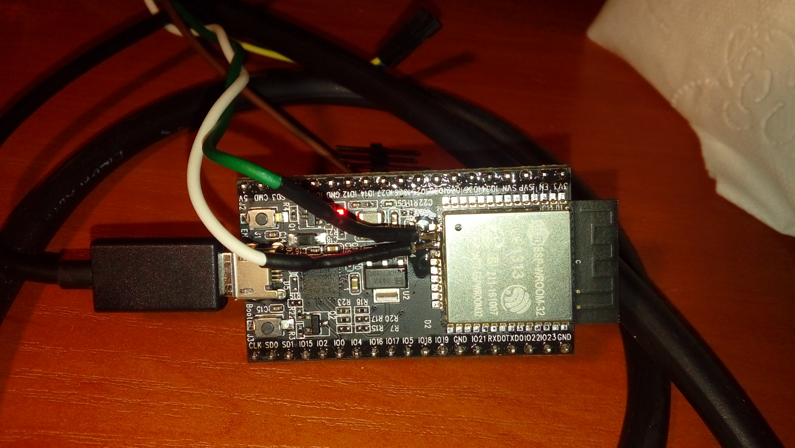

rudi can you send me yours bin files? I still have now working at all ... I made connection to UART1 with no results ...

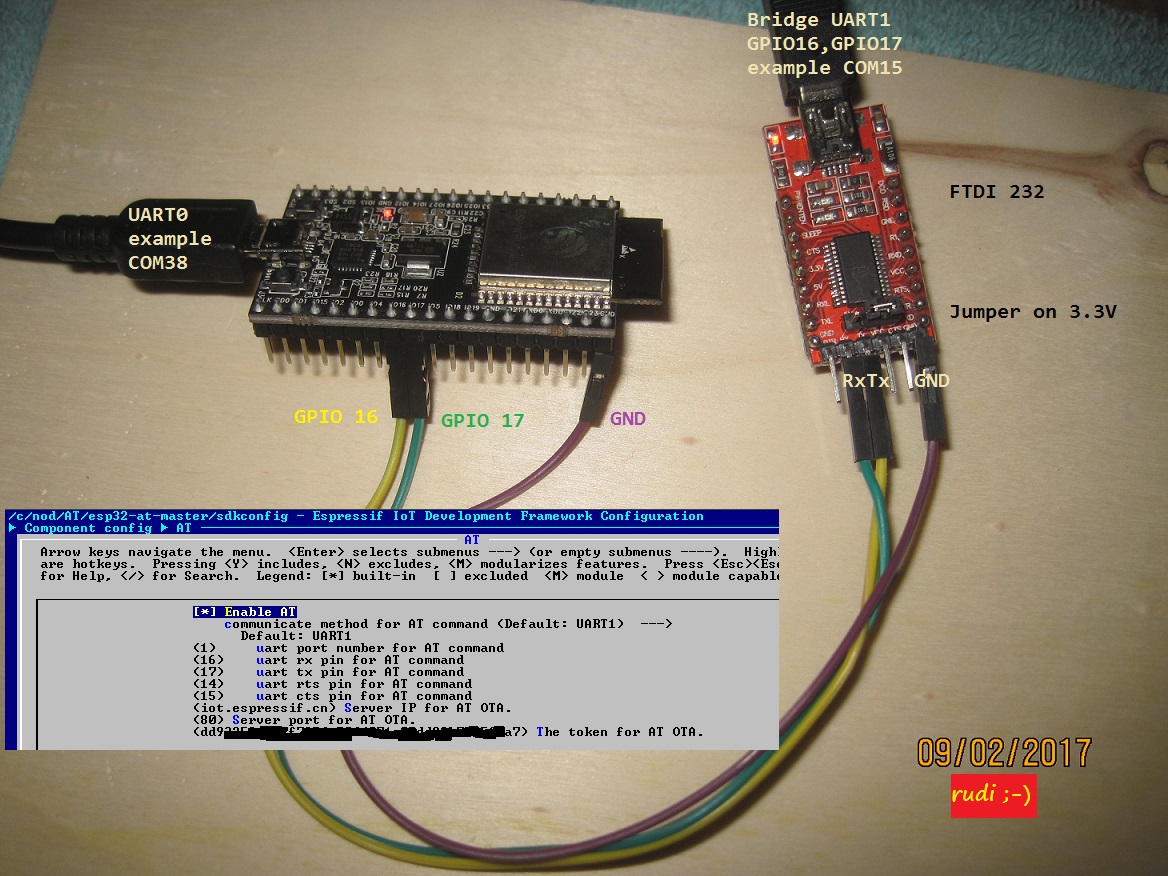

hi
can you not compile too?
will prepair this next step.
checkt this steps:
- ? gnd connect between the esp32 modul and the "terminal usb adapter/uart1 brigde"
- ? Rx, Tx not swapped
- ? CR+LF at and of AT Command
- ? after boot, the log is on UART0, the ready for AT Command comes on UART1
fyi:
why you connect to the pins of modul and not to the pinheader 16,17, GND?
have a look:
tested with DevKitC and FTDI 232 ( bridge the uart1 out for AT Commands..)

rudi - many thanks !!!! all works fine !! :) :)
thank you :)

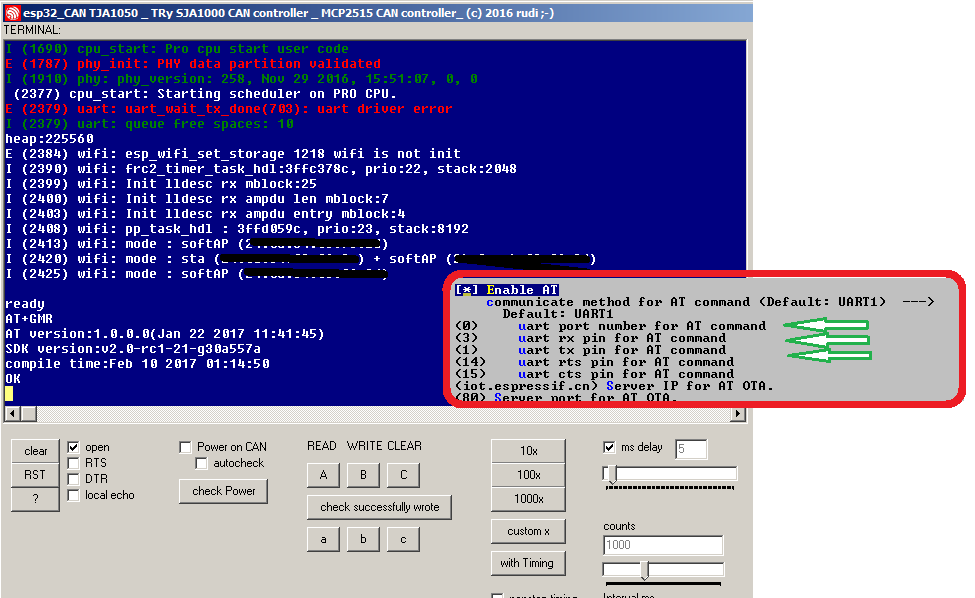

hi
only a thinking, have not tested just in time ( later time )
can we use uart0 as AT command port, too ?
does it be enough to set it in the sdkconfig ?

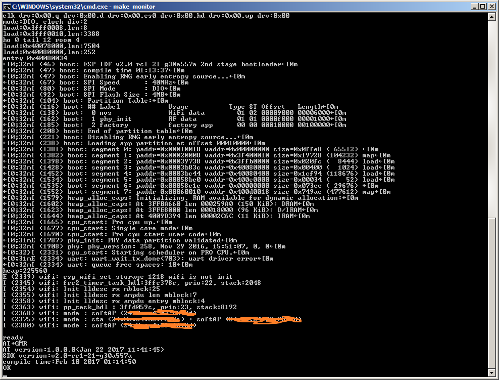

yes we can
( fine with make flash monitor too )
you do not need any more USB Adapter or others.
simple flash over the usb cable ( uart0 )
simple monitor over the usb cable ( uart0 )
"only one thing": uart_wait_tx_done(703): uart driver error
