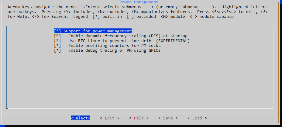

Am using esp32 Devkitc_V4 am executing an example code in esp-idf for both light sleep mode and deep sleep mode it consuming 8mA and 6mA respectivly.
Can anyone please help me to reduce power consumption.
I have made configuration as enabled all below under power management in esp-idf menuconfig
Support for power management
Enable dynamic frequency scaling (DFS) at startup
Use RTC timer to prevent time drift (EXPERIMENTAL)
Enable profiling counters for PM locks
Enable debug tracing of PM using GPIOs

Don't use the DevkitC as-is for low-power use: if any, the LDO on that board already eats up a fair few mA. There's a few posts on this board of people detailing how to modify it for lower power use by exchanging that part for a more energy efficient one, e.g. here.

Hi We have tried by by-passing that AMS117 LDO but still it consuming 5mA Don't know what went wrong
Please anyone help us to resolve the issue, is there any other configurations required??

Have you just bypassed it or have you taken it entirely out of the circuit?

We just bypassed it not taken out

Suggest you try that then. Chances are that the LDO is backfeeding itself and still burning a few mA.

Its working fine, thanks for your support.
