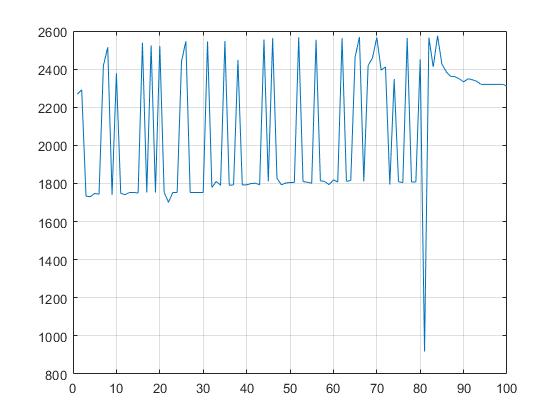

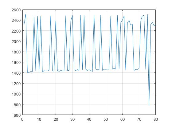

Hi All,
I am using a fast sampling ADC toghether with I2S. The goal is sampling the CAN bus (CAN_L) once a new data frame is incoming in the queue.
To get kind of syncronization I just do the i2s_adc_enable if there is a message in CAN message incoming, like reported below:
if(xQueueReceive(CAN_cfg.rx_queue,&rx_frame, 3*portTICK_PERIOD_MS)==pdTRUE){
      i2s_adc_enable(I2S_NUM_0);
      i2s_read(I2S_NUM_0, &buffer1, sizeof(buffer1), &bytes_read, 10);
      i2s_adc_disable(I2S_NUM_0);
By doing so, I get bit of ACK sometimes around 80 sample (over 100) (see CAN01.jpg), sometimes around 60/100 sample (see CAN02.jpg).
The question is: Is there a way to trigger the ADC with the SOF (start of frame bit) of the CAN frame on the CAN bus?
I set the ADC to obtain a sample per bit (500kpbs since the CAN network is configured with a data rate of 500kbps).
Currently no, the CAN controller will only generate an interrupt once a CAN message has been confirmed valid (i.e., Acknowledged and CRC is checked).
If you need an interrupt on the SOF, I think you might be better of routing the RX signal of your to a GPIO interrupt.

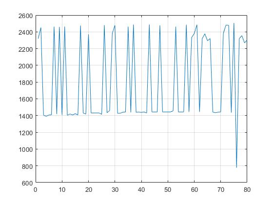

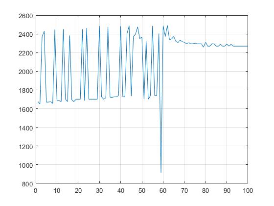

Many thanks for the suggestion.
I connected Pin 26 to the RX of the transceiver (sn65hvd230), so once the SOF rising is incoming it runs the ISR that do the i2s_adc_enable (see code below). In this way I can get a better syncronization (even if i loose some bit at beginning).
At least it seems something that it is replicable, as shown in CANsamples01 & 02. Same packet is sent but at different time.
Any other suggestion to improve the code? Thanks again a lot. :D
