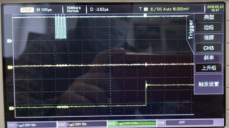

Esp32 works in spi master mode and keeps sending data to a spi slaver.
After more than 30 minutes,we found that sometimes the data on MOSI is different from the data which we put in "spi_device_transmit()".
Once the mismatch occurs. the scope stops and we take the picture like this:
channel 1 is spi clk;
channel 2 is spi mosi;
channel 3 is gpio signal from slaver(just to trig scope)
and we can find 8 pulses with no data on MOSI.
The spi mode is :
13.333Mhz
mode 3
HSPI_HOST
DMA enable
Help!!!!

You did not manage to add a picture... Also, can you share the code that does the transmission?

Strange... your code itself looks good. What ESP-IDF version are you using? What else is your code doing?

Postby JonathanChen » Thu Feb 04, 2021 5:44 am
Release 3.3.4
hardware :esp32-wroom-32
My code has almost 10~15 tasks ,and WIFI, LWIP and BLE.
And I will check the value in " spiTxBuf[0]" before put it in "spi_device_transmit";
For now ,we try to make sure if there is some bug in our code.

For your anomaly tracing, it is often very worthwhile to use the Chip Select line down transition as a trigger for the scope.

update the code with idf-4.3-beta1.
And after a long test, it works well.
May be we solved it. :D :D :D :D :D
