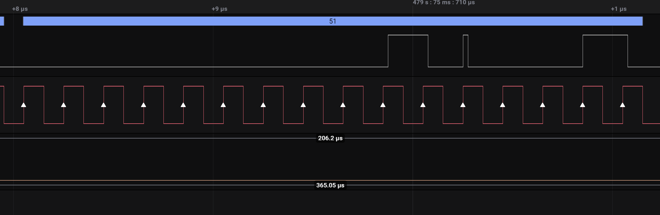

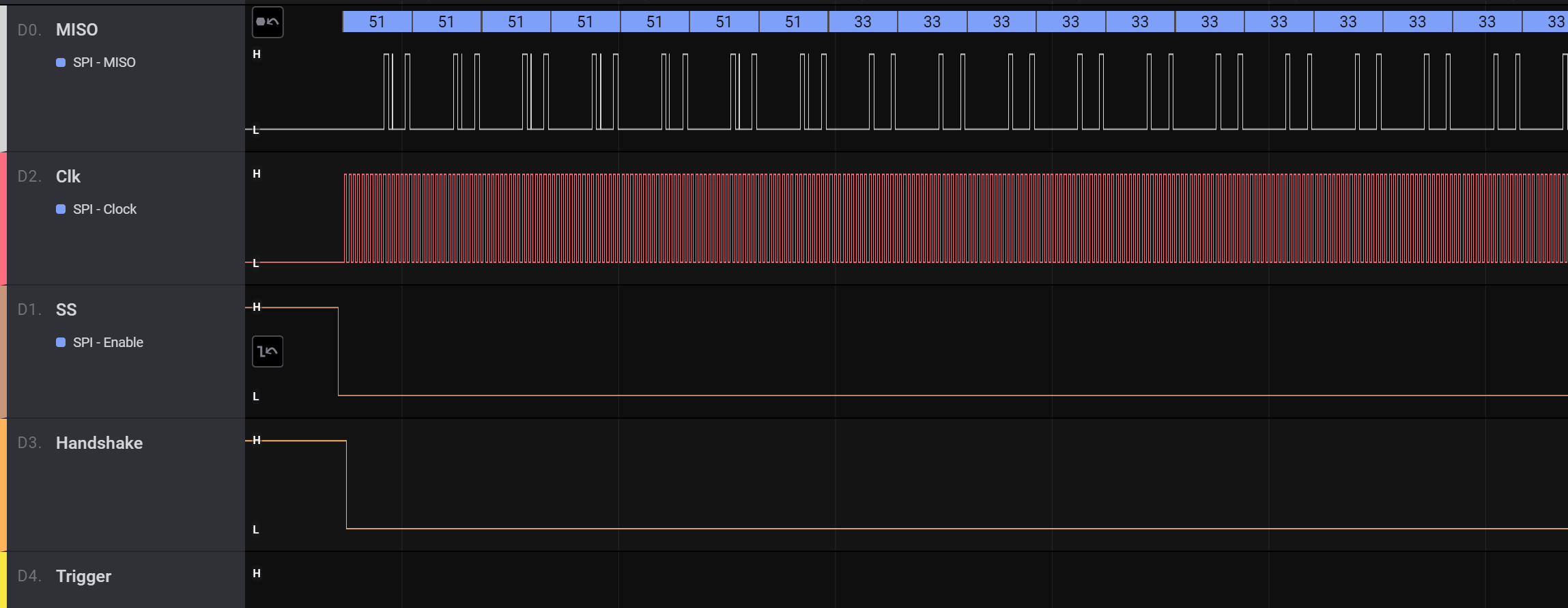

Hello everyone, im using SPI to communicate my FPGA to my ESP32, i'm currently sending a stream of decimal numbers (all 33, 16bit transaction), sometimes the data isnt registered correctly, as shown in the screenhot. Seems like the MISO line is not completely stable (?). I'm gonna post my code and the screenshot I'm talking about!

What logic analyzer and what sampling rate do you use?

I'm using Logic16 with 40MS/s.

It seems like that is only showing on the logic analyzer, the ESP actually receives the right data.
