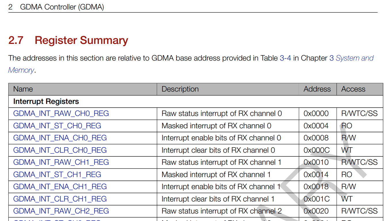

In a peripheral registers section of a technical reference manual, what the meaning of "SS" and "WTC" access types?

WTC is Write To Clear. SS, I don't know; do you have a particular bit where it appears? I'll see if we can do something about those abbreviations; you're not the only one having a hard time figuring out what everything stands for; it would be good to be able to hover over those things and get whatever it stands for.

Postby alqou91 » Mon Jan 24, 2022 3:22 pm
Thanks for the reply.
You can find "SS" in such as ESP32­C3 Technical Reference Manual, see attached image.
https://www.espressif.com/sites/default ... ual_en.pdf
"SS" seems related to RAW register?
I also find "WT" access type and this seems related CLR register...?

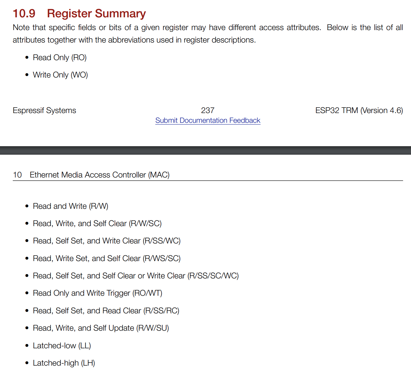

Finally I found the answer in ESP32 technical reference manual.
スクリーンショット 2022-01-28 1.51.01.png (223.34 KiB) Viewed 11956 times
