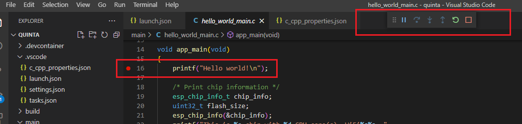

Please, I need help to make debug work on ESP32S3.
Trying with "Hello World" sample
First I tried debug using Esp-IDF version 4.4.2... many Jtag errors. It was impossible to flash code. Read and tried almost every suggestion I found on Google.
Then decided to try new version, I´ve installed version release branch 5.0, improved a lot, now I can flash code using Builtin JTAG.
The problem is that when the I start Debugging (play button/F5) , the debugger doesn't stop at the app_main() statement, but debug controls are on top page (see image).
When start debugging (Play button / F5) I receive message on DEBUG_CONSOLE as you can see in "terminal_debug_console.txt" file attached.
If I press "pause", I receive message on DEBUG_CONSOLE as you can see in "terminal_debug_console_press_pause.txt" file attached.
If I press "step over", I receive message this message
1: (259542) <-1025-exec-next
1: (259544) ->1025^error,msg="Cannot find bounds of current function"
1: (259544) ->(gdb)
1: (259544) 1025: elapsed time 2
1: (259544) ->&"\n"
1: (259544) ->^done
1: (259544) ->(gdb)
1: (259548) Send Event AD7MessageEvent
ERROR: Unexpected GDB output from command "-exec-next". Cannot find bounds of current function
terminal_debug_console_press_stepover.txt" file attached.
This is my LAUNCH.JSON

This is my "SETTINGS.JSON"
"C_Cpp.intelliSenseEngine": "Tag Parser",
"idf.adapterTargetName": "esp32s3",
"idf.customExtraPaths": "C:\\Espressif\\tools\\xtensa-esp-elf-gdb\\11.2_20220808\\xtensa-esp-elf-gdb\\bin;C:\\Espressif\\tools\\riscv32-esp-elf-gdb\\11.2_20220808\\riscv32-esp-elf-gdb\\bin;C:\\Espressif\\tools\\xtensa-esp32-elf\\esp-2022r1-RC1-11.2.0\\xtensa-esp32-elf\\bin;C:\\Espressif\\tools\\xtensa-esp32s2-elf\\esp-2022r1-RC1-11.2.0\\xtensa-esp32s2-elf\\bin;C:\\Espressif\\tools\\xtensa-esp32s3-elf\\esp-2022r1-RC1-11.2.0\\xtensa-esp32s3-elf\\bin;C:\\Espressif\\tools\\riscv32-esp-elf\\esp-2022r1-RC1-11.2.0\\riscv32-esp-elf\\bin;C:\\Espressif\\tools\\esp32ulp-elf\\2.28.51-esp-20191205\\esp32ulp-elf-binutils\\bin;C:\\Espressif\\tools\\esp32s2ulp-elf\\2.28.51-esp-20191205\\esp32s2ulp-elf-binutils\\bin;C:\\Espressif\\tools\\cmake\\3.23.1\\bin;C:\\Espressif\\tools\\openocd-esp32\\v0.11.0-esp32-20220706\\openocd-esp32\\bin;C:\\Espressif\\tools\\ninja\\1.10.2;C:\\Espressif\\tools\\idf-exe\\1.0.3;C:\\Espressif\\tools\\ccache\\4.3\\ccache-4.3-windows-64;C:\\Espressif\\tools\\dfu-util\\0.9\\dfu-util-0.9-win64",
"idf.customExtraVars": "{\"OPENOCD_SCRIPTS\":\"C:\\\\Espressif\\\\tools\\\\openocd-esp32\\\\v0.11.0-esp32-20220706/openocd-esp32/share/openocd/scripts\",\"IDF_CCACHE_ENABLE\":\"1\"}",
"idf.espIdfPathWin": "C:\\Users\\pc-linux\\esp\\esp-idf",
"idf.openOcdConfigs": [
"board/esp32s3-builtin.cfg"
"idf.portWin": "COM12",
"idf.pythonBinPathWin": "C:\\Espressif\\python_env\\idf5.0_py3.8_env\\Scripts\\python.exe",
"idf.toolsPathWin": "C:\\Espressif",
"idf.flashType": "JTAG"
if someone has already managed to connect with ESP-PROG, it would help me a lot as well, as you managed to do this, I tried several ways, but without success.
I really appreciate if anyone can help me, I have this problem for two weeks
Thank You

Postby ifoxbr » Fri Aug 26, 2022 5:03 pm
Solved !!!
Most of my problems were the wrong documentation

Re: Help on ESP32-S3 builtin JTAG debug on VSCODE (Windows 10)
Postby ifoxbr » Thu Oct 27, 2022 5:23 pm
Please, install ESP-IDF Versin 5.0 from VS Config IDF extension
And change your "settings.json" to this
Code: Untitled.xml Select all
"idf.customExtraPaths": "C:\\Espressif\\tools\\xtensa-esp-elf-gdb\\11.2_20220823\\xtensa-esp-elf-gdb\\bin;C:\\Espressif\\tools\\riscv32-esp-elf-gdb\\11.2_20220823\\riscv32-esp-elf-gdb\\bin;C:\\Espressif\\tools\\xtensa-esp32-elf\\esp-2022r1-11.2.0\\xtensa-esp32-elf\\bin;C:\\Espressif\\tools\\xtensa-esp32s2-elf\\esp-2022r1-11.2.0\\xtensa-esp32s2-elf\\bin;C:\\Espressif\\tools\\xtensa-esp32s3-elf\\esp-2022r1-11.2.0\\xtensa-esp32s3-elf\\bin;C:\\Espressif\\tools\\riscv32-esp-elf\\esp-2022r1-11.2.0\\riscv32-esp-elf\\bin;C:\\Espressif\\tools\\esp32ulp-elf\\2.28.51-esp-20191205\\esp32ulp-elf-binutils\\bin;C:\\Espressif\\tools\\esp32s2ulp-elf\\2.28.51-esp-20191205\\esp32s2ulp-elf-binutils\\bin;C:\\Espressif\\tools\\cmake\\3.23.1\\bin;C:\\Espressif\\tools\\openocd-esp32\\v0.11.0-esp32-20220706\\openocd-esp32\\bin;C:\\Espressif\\tools\\ninja\\1.10.2;C:\\Espressif\\tools\\idf-exe\\1.0.3;C:\\Espressif\\tools\\ccache\\4.6.2\\ccache-4.6.2-windows-x86_64;C:\\Espressif\\tools\\dfu-util\\0.9\\dfu-util-0.9-win64",
"interface/ftdi/esp32_devkitj_v1.cfg",
"target/esp32s3.cfg"
"idf.portWin": "COM23",
"idf.flashType": "UART"
