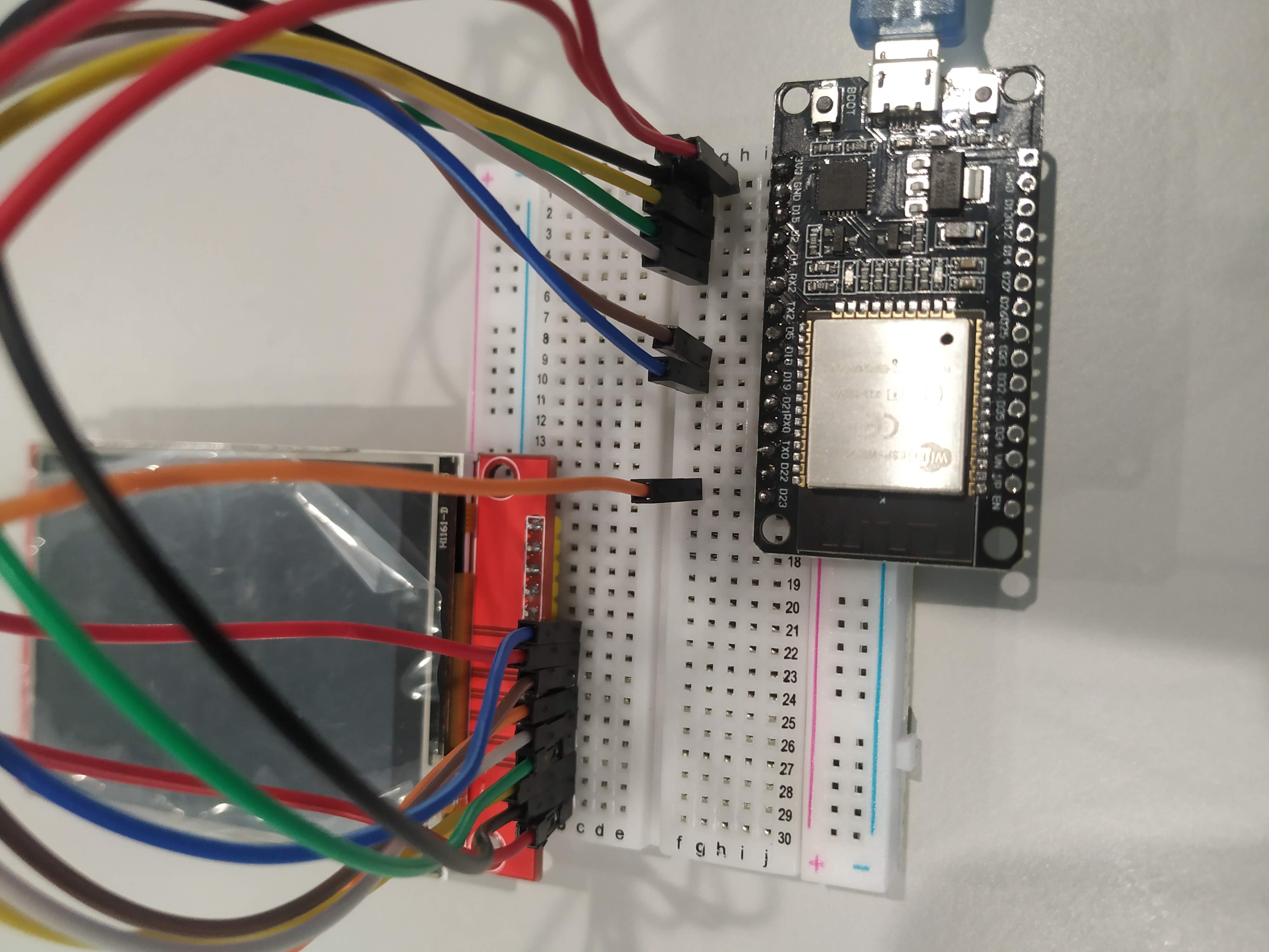

Postby whateverfast » Fri Nov 04, 2022 5:19 am
I am trying to do this project: https://electropeak.com/learn/interfaci ... ith-esp32/
I have an ESP32S and a TFT SP1 2.8. I installed the TFT_eSPI libraries (using arduino ide) and edit the USER_SETUP file with the appropriate PINS and versions (I believe). However, I tried different configurations but I was unable to turn on the TFT. I know that the TFT is working because I have used it with another board.
In the USER_SETUP tried with different drivers: ILI9341_DRIVER and ILI9341_2_DRIVER and the result is the same. Also different PINS.
I also run with the differenr boards types: DO IT ESP32 DEVKIT V1, and other ones that also compile.
Can you please help :) Thank you
The pins are the following in the USER_SETUP file

Re: ESP32 + TFT not working - Screen Blank - Help!
Postby vritzka » Sat Nov 05, 2022 1:15 pm
Does at least the background light turn on?
whateverfast
Joined: Fri Nov 04, 2022 4:50 am
Postby whateverfast » Sun Nov 06, 2022 2:26 am
The background light flickers when I press the reset button. I have also tried with a different library and still no success. I double-checked the pins but had no success. Any ideas?
Postby vritzka » Mon Nov 07, 2022 2:31 am
The screen backlight should glow up as soon as you connect 3.3 V and ground.
Since its an LED, you need to connect it through a resistor (100 OHM would work).
It seems there is no resistor now. So maybe the high current draw makes the ESP32 turn off and thats why it doesn't work.
