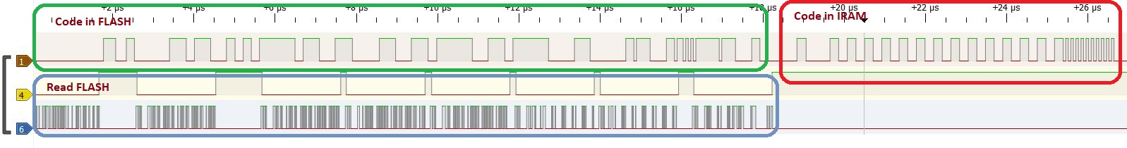

 gpio_set_level(GPIO_BLINK, 1);
 gpio_set_level(GPIO_BLINK, 0);
 GPIO.out_w1ts = mask;
 GPIO.out_w1tc = mask;
when code in flash memory and IRAM and the process of swapping cache from flash memory

Likely: Caching, possibly: synchronization of the CPU with the APB and the GPIO peripheral.
You can look into Dedicated GPIO to improve the latter, and put code into IRAM to avoid cache issues.
