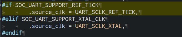

I installed the current master build and do see changes for preprocessor #id/#elif/#endif but they're not very useful right now.
Here's how it looks in the CDT editor...
It's really clear what's going on.
Here's how it looks in the LSP editor...
The green text is the same color as the comments and doesn't really make it obvious that that code is inactive and the #elif should be "active". I don't see any way to change the colors.
Of course, you still can't fold them either.

For the inactive code BLOCK highlight, I appreciate the effort, but yea, that really is not it. Could we just change the background color of whole inacive line(s) and leave everthing else the same?
Yeah that would be a good way to do it for now.

Inactive code block is implemented with the v3.1.0, please see if that's helpful.
https://github.com/espressif/idf-eclips ... tag/v3.1.0
martins
Posts: 72
Joined: Tue Aug 24, 2021 8:58 am
Re: Very disappointed in the decision to use the C/C++ (LSP) editor
Postby martins » Mon Dec 02, 2024 8:29 am
I tried the v3.1.0, but inactive code is still marked as comment instead of just background highlight of whole block while keeping original syntax highlight. Unless I missed some settings?
See https://github.com/clangd/vscode-clangd ... 1502199447 for reference.
