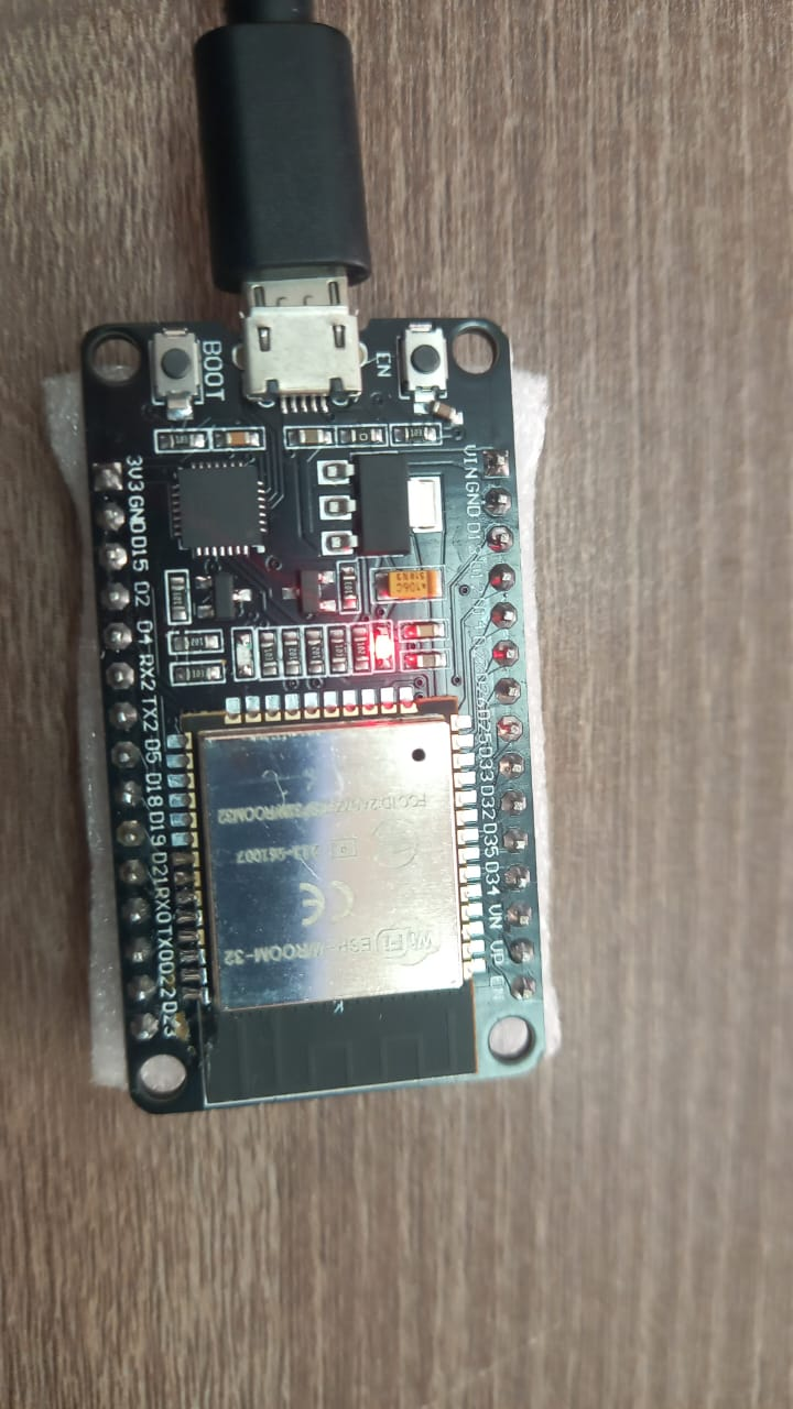

1. Using ESP-WROOM-32 kit as in attached mail. THis kit has Silabs CP2102 on it.
Kit is connected to PC via USB cable (attached pic)

5. One doubt I have is can we debug ESp-wroom-32 kit as in pic1 attahced over USB?
Or I am making some mistake

You need to connect a debug probe to the jtag pins, see https://docs.espressif.com/projects/esp ... -jtag.html

Can you plz help to share the ESP32 debugger which can buy online & then connect to ESP-Wroom-32(as in attached image) for debug purpose

Look for an ESP-Prog board. For more detail also read through Espressif's JTAG debugging guide. The ESP-Prog uses an FT2232H USB bridge chip, so you can also use a simple breakout board with an FT2232H or FT232H chip. Other JTAG adapter options that can be used with OpenOCD: https://openocd.org/doc/html/Debug-Adap ... dware.html
So there is no way to debug an ESP32-WROOM* without using a separate JTAG device ? The on board USB interface allows for flashing only ?
*But the ESP32-C3 WROOM appears to be debuggable with esp_usb_jtag according to "Other" in this: https://openocd.org/doc/html/Debug-Adap ... dware.html ?
