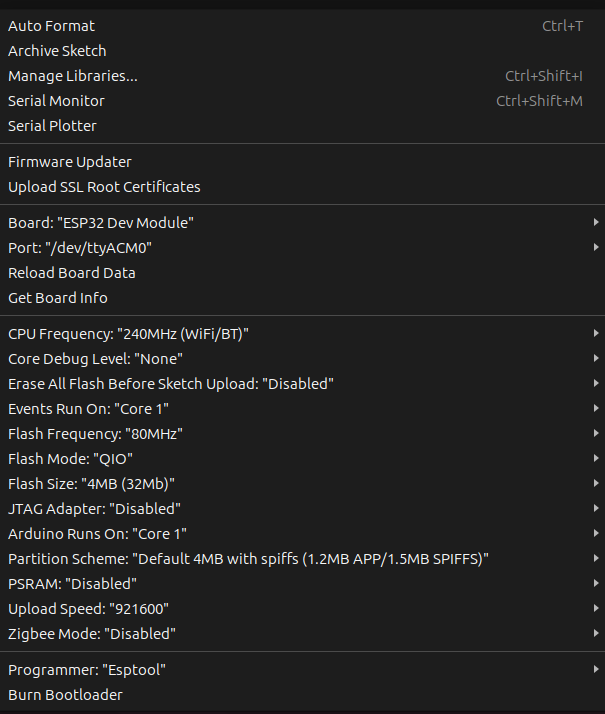

Not sure if this can help, but I'm attaching an image that show all information that Arduino IDE provide me about my esp32 device, when I successfully run a simple example for blink led.
Screenshot from 2025-03-23 07-25-43.png (60.46 KiB) Viewed 1057 times
Screenshot from 2025-03-23 07-14-49.png (13.22 KiB) Viewed 1057 times
