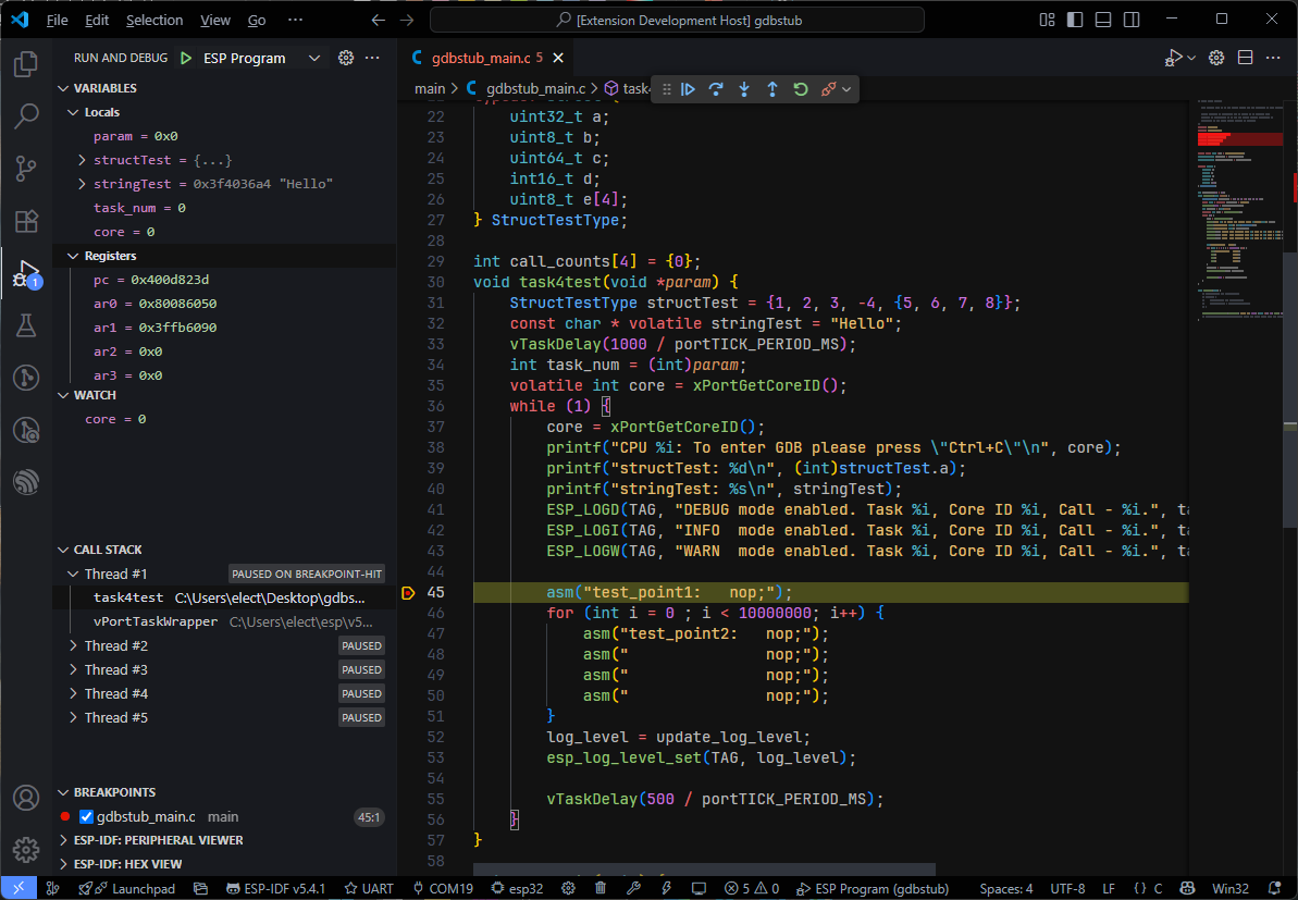

Hi everyone,
I’m excited to share my project, ESP Debug, a VSCode extension to debug ESP32 via COM ports. It’s designed to simplify the debugging process and make it more accessible for developers working with ESP32 devices.
Features:
  • Works with ESP-IDF's built-in GDB Stub.
  • COM Port Communication: Just connect the built-in COM port on ESP32 board to debug.
  • Basic debugging features:
    • Pause, Continue, Stop, Restart, Step Over, Step Into, Step Out.
    • Stack trace for each thread.
    • Set and remove breakpoints.
    • View local variables, CPU registers and evaluate expressions.
    • Show messages logged from target.
How to Use:
  1. Check out the project on GitHub: ESP-Debug Repository.
  2. Install the extension from the VSCode marketplace: ESP-Debug Extension.
  3. Follow the setup guide, and start debugging your ESP32 with ease!
It’s open-source, so feel free to contribute or leave feedback. Let me know what you think!
