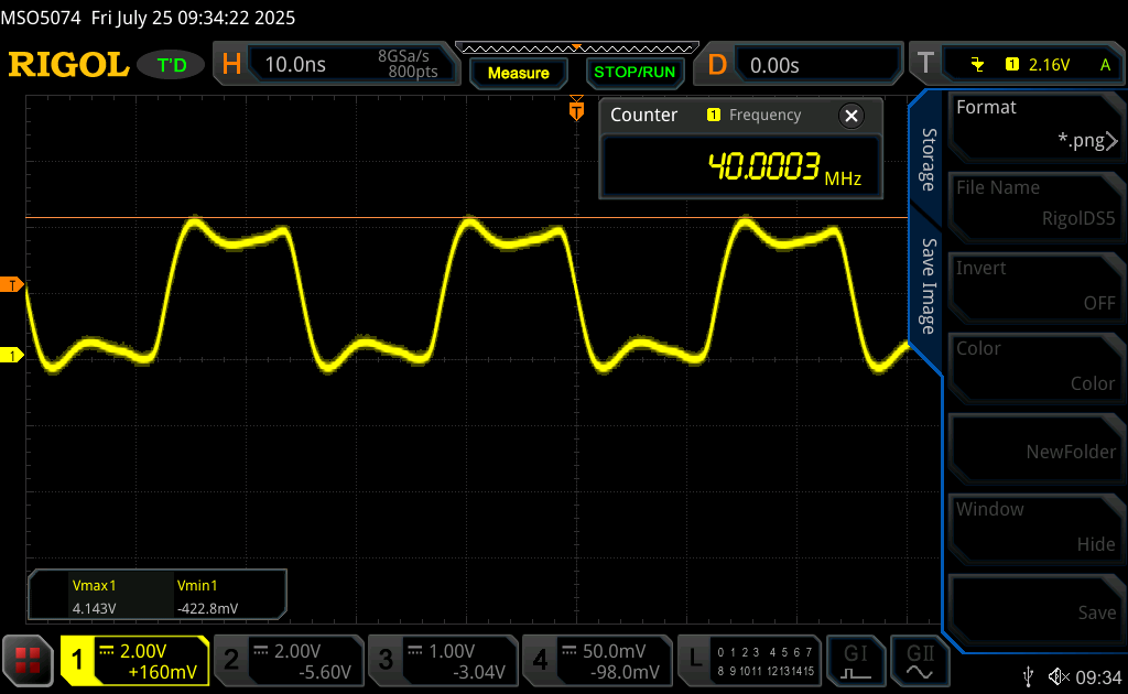

- Using ESP-IDF v5.4.2
- Using an ESP32-C3-DevkitM-1 v1.0
- Example examples/peripherals/ledc/ledc_basic
- Modify main/ledc_basic_example_main.c as such:
#define LEDC_OUTPUT_IO          (10) // Define the output GPIO
#define LEDC_DUTY_RES           LEDC_TIMER_1_BIT // Set duty resolution to 1 bit
#define LEDC_FREQUENCY          (40000000) // Frequency in Hertz. Set frequency at 40MHz
- Probing GPIO10:
Given that I get a proper 40MHz, I'd imagine there may be something wrong with your setup. Do you have something else (a logic analyzer or an oscilloscope, for instance) that can verify your measurement?

Thanks @Sprite and everything is working after your LEDC suggestion.
It appears my AI generated code set the duty cycle to 0 (should be 4096) and I had not modified the ESP-IDF LECD basic sample from LEDC_TIMER_13_BIT to LEDC_TIMER_1_BIT resolution. Nothing was working with those mistakes.
