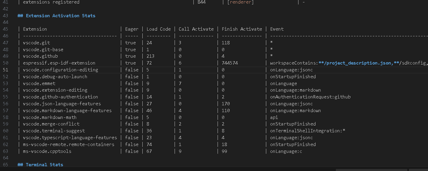

I tried a clean install again with the online exe program. Fails again. I include the log from today attempt.
This frustrating as before the current failed esp-idf installation, it is very slow using vscode insider with the esp-idf extension as it takes a long time(more than 20mins) scanning for kits when I start vscode and when I try to build.
I notice this error keeps cropping up
Cannot find: "${env:IDF_PATH}/components/"
which goes away after the 20mins+ of scanning.
I don't see this in settings.json either. I assume its because the esp-idf has not installed properly and IDF_PATH is not set in win11 enviroment variables either
Anyone can help getting this solved???

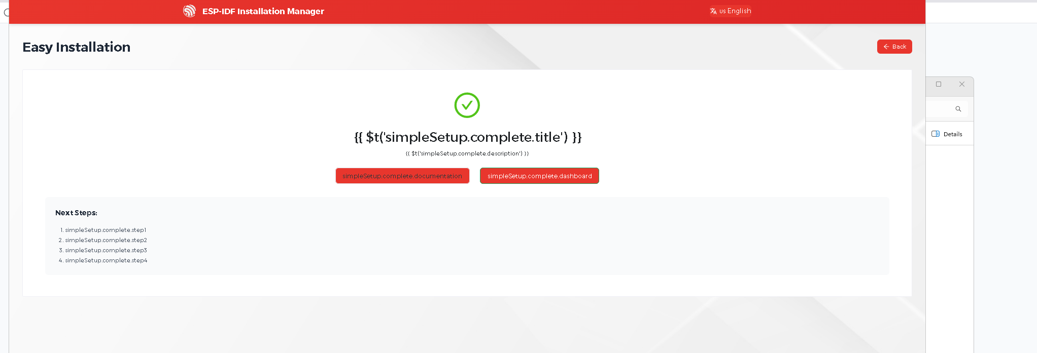

Re: espidftools setup online 2.3.5 fail multiple time
We are close to announcing the replacement of this installer.
Can you give it a try and share your experience?
https://dl.espressif.com/dl/eim/

{"message":"Cannot access filePath: f:\\temp\\ESP32\\projects\\hello_world\\sdkconfig","stack":"Error: ENOENT: no such file or directory, access 'f:\\temp\\ESP32\\projects\\hello_world\\sdkconfig'\n\tat Object.accessSync (node:fs:244:11)\n\tat t.accessSync (node:electron/js2c/node_init:2:9395)\n\tat ct (c:<HOMEPATH>\\.vscode-insiders\\extensions\\espressif.esp-idf-extension-1.10.2\\dist\\extension.js:2:1471825)\n\tat bt (c:<HOMEPATH>\\.vscode-insiders\\extensions\\espressif.esp-idf-extension-1.10.2\\dist\\extension.js:2:1474173)\n\tat async et (c:<HOMEPATH>\\.vscode-insiders\\extensions\\espressif.esp-idf-extension-1.10.2\\dist\\extension.js:2:1469508)\n\tat async od.value (c:<HOMEPATH>\\.vscode-insiders\\extensions\\espressif.esp-idf-extension-1.10.2\\dist\\extension.js:2:1888983)","category":"src utils canAccessFile","level":"error","timestamp":"2025-10-05T15:36:01.916Z"}
{"command":"c:<HOMEPATH>\\.espressif\\python_env\\idf5.5_py3.11_env\\Scripts\\python.exe","message":"Not using an unsupported version of tool cmake found in PATH: 3.11.1. To use it, run 'c:<HOMEPATH>\\.espressif\\python_env\\idf5.5_py3.11_env\\Scripts\\python.exe C:<HOMEPATH>\\esp\\v5.5.1\\esp-idf\\tools\\idf_tools.py export --prefer-system'\r\n","stack":"Error: Not using an unsupported version of tool cmake found in PATH: 3.11.1. To use it, run 'c:<HOMEPATH>\\.espressif\\python_env\\idf5.5_py3.11_env\\Scripts\\python.exe C:<HOMEPATH>\\esp\\v5.5.1\\esp-idf\\tools\\idf_tools.py export --prefer-system'\r\n\n\tat \\dist\\extension.js:2:1475262\n\tat ChildProcess.exithandler (node:child_process:411:7)\n\tat ChildProcess.emit (node:events:519:28)\n\tat maybeClose (node:internal/child_process
16)\n\tat ChildProcess._handle.onexit (node:internal/child_process:304:5)","category":"utils execChildProcess stderr","level":"error","timestamp":"2025-10-05T15:53:27.509Z"}
16)\n\tat ChildProcess._handle.onexit (node:internal/child_process:304:5)","category":"utils execChildProcess stderr","level":"error","timestamp":"2025-10-05T15:56:56.967Z"}
16)\n\tat ChildProcess._handle.onexit (node:internal/child_process:304:5)","category":"utils execChildProcess stderr","level":"error","timestamp":"2025-10-05T16:00:26.388Z"}
{"user":true,"message":"Failed to flash because of some unusual error. Check Terminal for more details","stack":"Error: Task ESP-IDF Flash exited with code 2\n\tat c:<HOMEPATH>\\.vscode-insiders\\extensions\\espressif.esp-idf-extension-1.10.2\\dist\\extension.js:2:1653619\n\tat od.value (file:///c:<HOMEPATH>/AppData/Local/Programs/Microsoft%20VS%20Code%20Insiders/resources/app/out/vs/workbench/api/node/extensionHostProcess.js:201:103122)\n\tat $.C (file:///c:<HOMEPATH>/AppData/Local/Programs/Microsoft%20VS%20Code%20Insiders/resources/app/out/vs/workbench/api/node/extensionHostProcess.js:27:2373)\n\tat $.fire (file:///c:<HOMEPATH>/AppData/Local/Programs/Microsoft%20VS%20Code%20Insiders/resources/app/out/vs/workbench/api/node/extensionHostProcess.js:27:2591)\n\tat uA.$onDidEndTaskProcess (file:///c:<HOMEPATH>/AppData/Local/Programs/Microsoft%20VS%20Code%20Insiders/resources/app/out/vs/workbench/api/node/extensionHostProcess.js:123:13396)","category":"flashCommand unknown error","level":"error","timestamp":"2025-10-05T16:00:27.894Z"}
16)\n\tat ChildProcess._handle.onexit (node:internal/child_process:304:5)","category":"utils execChildProcess stderr","level":"error","timestamp":"2025-10-05T16:08:10.601Z"}
16)\n\tat ChildProcess._handle.onexit (node:internal/child_process:304:5)","category":"utils execChildProcess stderr","level":"error","timestamp":"2025-10-05T16:23:39.154Z"}
{"command":"c:<HOMEPATH>\\.espressif\\python_env\\idf5.5_py3.11_env\\Scripts\\python.exe","message":"non zero exit code null\r\n\r\nesptool.py v4.10.0\r\nSerial port COM9\r\nConnecting....\r\nDetecting chip type... ESP32-S3\r\nChip is ESP32-S3 (QFN56) (revision v0.1)\r\nFeatures: WiFi, BLE\r\nCrystal is 40MHz\r\nMAC: 7c:df:a1:e2:e9:e4\r\nUploading stub...\r\n","stack":"Error: non zero exit code null\r\n\r\nesptool.py v4.10.0\r\nSerial port COM9\r\nConnecting....\r\nDetecting chip type... ESP32-S3\r\nChip is ESP32-S3 (QFN56) (revision v0.1)\r\nFeatures: WiFi, BLE\r\nCrystal is 40MHz\r\nMAC: 7c:df:a1:e2:e9:e4\r\nUploading stub...\r\n\n\tat ChildProcess.<anonymous> (\\dist\\extension.js:2:1471625)\n\tat ChildProcess.emit (node:events:519:28)\n\tat ChildProcess._handle.onexit (node:internal/child_process:293:12)","category":"src utils spawn","level":"error","timestamp":"2025-10-05T19:07:48.127Z"}
16)\n\tat ChildProcess._handle.onexit (node:internal/child_process:304:5)","category":"utils execChildProcess stderr","level":"error","timestamp":"2025-10-05T19:23:41.650Z"}
16)\n\tat ChildProcess._handle.onexit (node:internal/child_process:304:5)","category":"utils execChildProcess stderr","level":"error","timestamp":"2025-10-05T19:46:31.351Z"}
16)\n\tat ChildProcess._handle.onexit (node:internal/child_process:304:5)","category":"utils execChildProcess stderr","level":"error","timestamp":"2025-10-05T20:02:33.436Z"}
16)\n\tat ChildProcess._handle.onexit (node:internal/child_process:304:5)","category":"utils execChildProcess stderr","level":"error","timestamp":"2025-10-05T21:49:32.754Z"}
16)\n\tat ChildProcess._handle.onexit (node:internal/child_process:304:5)","category":"utils execChildProcess stderr","level":"error","timestamp":"2025-10-05T22:12:05.546Z"}
16)\n\tat ChildProcess._handle.onexit (node:internal/child_process:304:5)","category":"utils execChildProcess stderr","level":"error","timestamp":"2025-10-06T07:53:10.956Z"}
16)\n\tat ChildProcess._handle.onexit (node:internal/child_process:304:5)","category":"utils execChildProcess stderr","level":"error","timestamp":"2025-10-06T08:10:11.080Z"}
{"message":"Cannot access filePath: ${env:ADF_PATH}","stack":"Error: ENOENT: no such file or directory, access 'C:<HOMEPATH>\\AppData\\Local\\Programs\\Microsoft VS Code Insiders\\${env:ADF_PATH}'\n\tat Object.accessSync (node:fs:244:11)\n\tat t.accessSync (node:electron/js2c/node_init:2:9395)\n\tat ct (c:<HOMEPATH>\\.vscode-insiders\\extensions\\espressif.esp-idf-extension-1.10.2\\dist\\extension.js:2:1471825)\n\tat c:<HOMEPATH>\\.vscode-insiders\\extensions\\espressif.esp-idf-extension-1.10.2\\dist\\extension.js:2:1695963\n\tat $a (c:<HOMEPATH>\\.vscode-insiders\\extensions\\espressif.esp-idf-extension-1.10.2\\dist\\extension.js:2:1697104)\n\tat process.processTicksAndRejections (node:internal/process/task_queues:105:5)\n\tat async c:<HOMEPATH>\\.vscode-insiders\\extensions\\espressif.esp-idf-extension-1.10.2\\dist\\extension.js:2:1944004","category":"src utils canAccessFile","level":"error","timestamp":"2025-10-06T08:10:11.081Z"}
{"message":"Cannot access filePath: ${env:MDF_PATH}","stack":"Error: ENOENT: no such file or directory, access 'C:<HOMEPATH>\\AppData\\Local\\Programs\\Microsoft VS Code Insiders\\${env:MDF_PATH}'\n\tat Object.accessSync (node:fs:244:11)\n\tat t.accessSync (node:electron/js2c/node_init:2:9395)\n\tat ct (c:<HOMEPATH>\\.vscode-insiders\\extensions\\espressif.esp-idf-extension-1.10.2\\dist\\extension.js:2:1471825)\n\tat c:<HOMEPATH>\\.vscode-insiders\\extensions\\espressif.esp-idf-extension-1.10.2\\dist\\extension.js:2:1696141\n\tat $a (c:<HOMEPATH>\\.vscode-insiders\\extensions\\espressif.esp-idf-extension-1.10.2\\dist\\extension.js:2:1697104)\n\tat process.processTicksAndRejections (node:internal/process/task_queues:105:5)\n\tat async c:<HOMEPATH>\\.vscode-insiders\\extensions\\espressif.esp-idf-extension-1.10.2\\dist\\extension.js:2:1944004","category":"src utils canAccessFile","level":"error","timestamp":"2025-10-06T08:10:11.081Z"}
{"message":"Cannot access filePath: ${env:ESP_MATTER_PATH}","stack":"Error: ENOENT: no such file or directory, access 'C:<HOMEPATH>\\AppData\\Local\\Programs\\Microsoft VS Code Insiders\\${env:ESP_MATTER_PATH}'\n\tat Object.accessSync (node:fs:244:11)\n\tat t.accessSync (node:electron/js2c/node_init:2:9395)\n\tat ct (c:<HOMEPATH>\\.vscode-insiders\\extensions\\espressif.esp-idf-extension-1.10.2\\dist\\extension.js:2:1471825)\n\tat c:<HOMEPATH>\\.vscode-insiders\\extensions\\espressif.esp-idf-extension-1.10.2\\dist\\extension.js:2:1696233\n\tat $a (c:<HOMEPATH>\\.vscode-insiders\\extensions\\espressif.esp-idf-extension-1.10.2\\dist\\extension.js:2:1697104)\n\tat process.processTicksAndRejections (node:internal/process/task_queues:105:5)\n\tat async c:<HOMEPATH>\\.vscode-insiders\\extensions\\espressif.esp-idf-extension-1.10.2\\dist\\extension.js:2:1944004","category":"src utils canAccessFile","level":"error","timestamp":"2025-10-06T08:10:11.081Z"}
{"message":"Cannot access filePath: ${env:HOMEKIT_PATH}","stack":"Error: ENOENT: no such file or directory, access 'C:<HOMEPATH>\\AppData\\Local\\Programs\\Microsoft VS Code Insiders\\${env:HOMEKIT_PATH}'\n\tat Object.accessSync (node:fs:244:11)\n\tat t.accessSync (node:electron/js2c/node_init:2:9395)\n\tat ct (c:<HOMEPATH>\\.vscode-insiders\\extensions\\espressif.esp-idf-extension-1.10.2\\dist\\extension.js:2:1471825)\n\tat c:<HOMEPATH>\\.vscode-insiders\\extensions\\espressif.esp-idf-extension-1.10.2\\dist\\extension.js:2:1696329\n\tat $a (c:<HOMEPATH>\\.vscode-insiders\\extensions\\espressif.esp-idf-extension-1.10.2\\dist\\extension.js:2:1697104)\n\tat process.processTicksAndRejections (node:internal/process/task_queues:105:5)\n\tat async c:<HOMEPATH>\\.vscode-insiders\\extensions\\espressif.esp-idf-extension-1.10.2\\dist\\extension.js:2:1944004","category":"src utils canAccessFile","level":"error","timestamp":"2025-10-06T08:10:11.081Z"}
{"message":"ENOENT: no such file or directory, open 'f:\\temp\\ESP32\\projects\\hello_world\\.vscode\\launch.json'","stack":"Error: ENOENT: no such file or directory, open 'f:\\temp\\ESP32\\projects\\hello_world\\.vscode\\launch.json'","category":"extension DoctorCommand","level":"error","timestamp":"2025-10-06T08:21:03.089Z"}
{"user":true,"level":"warn","message":"Extension configuration report has been copied to clipboard with errors","timestamp":"2025-10-06T08:21:03.089Z"}
