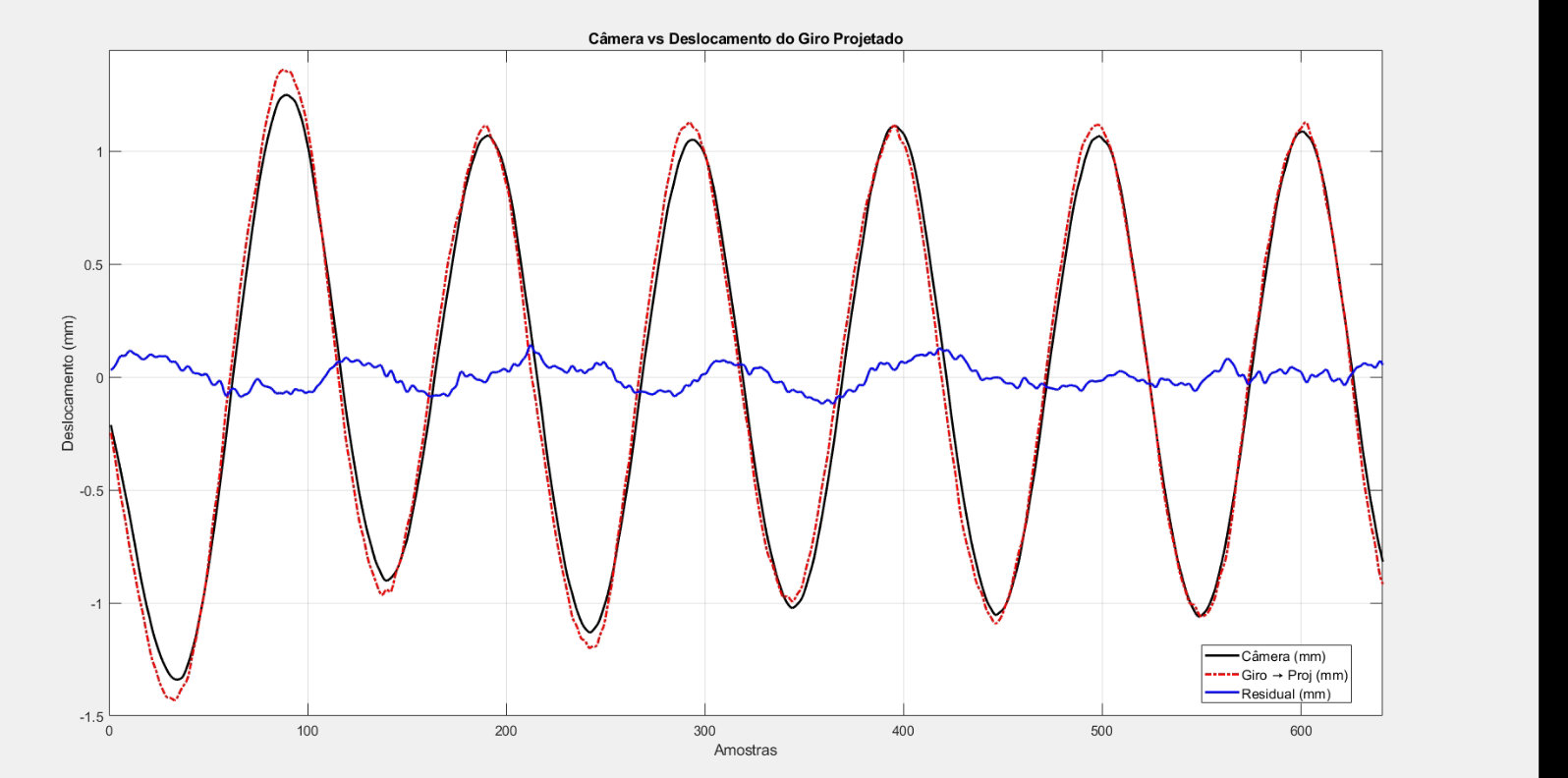

Hello everyone,
I am working with an ESP32 and an ICM-45686 IMU.
My goal is to acquire accelerometer and gyroscope data at 1.024 kHz and send it to a PC via serial. On the PC side, I have a Python script that receives the data and saves it.
I would like to evaluate whether the sampling rate of the ESP32 is actually stable. To check this, I compared the ESP32 data with a commercial data acquisition system, both synchronized by a trigger.
In the figure attached:
Black: measurement from the commercial system
Red: measurement from the ESP32
Blue: difference between the two signals
The signal is a measurement of a periodic movement of an object with 10 Hz of frequency.
We can observe that the difference (blue) is not just a fixed offset, but varies over time: the ESP32 signal starts slightly delayed and then seems to get ahead of the reference signal.
๐Ÿ‘‰ How should I interpret this behavior?
๐Ÿ‘‰ Does this variation in the blue residual indicate that the ESP32 sampling rate is not stable (jitter), or could there be another explanation?
I accept any suggestions.
THanks!

Postby Sprite » Fri Oct 03, 2025 9:13 am
The error is fairly small - I'm eyeballing that at the end the amplitude is about 1/3rd of the actual waveforms, meaning it leads or lags by (sin-1(0.333)/2*pi=)0.04 cycles. On a total of 80 cycles, that's about 0.05%. That is probably be explained by the fact that you're using ints for Ts, nextSampleTime etc - your Ts should be (1000000/1024)=976.562 but because you store it as an int, it's 976. That leads to an actual frequency of (1000000/976)=1024.59Hz, which indeed is off by 0.05%.

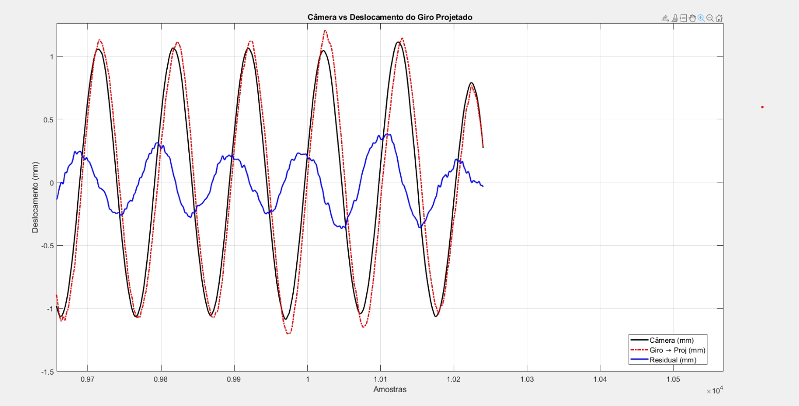

Hi @Sprite, thanks a lot for your explanation.
That was a very good observation โ€” I hadnโ€™t considered the effect of using int for Ts and nextSampleTime. Iโ€™ll update the code to use the correct precision and then come back here to share the new results.

Postby theluciansm » Fri Oct 03, 2025 3:20 pm
I changed for the following code

But Iโ€™m still observing a phase shift between the signals.
I attached a screenshot from the beginning and the end of the measurement.
Could the error be due to sending a large amount of data through the serial interfaceโ€”in other words, could the serial communication be bottlenecking the system? The sensorโ€™s ODR is set to 1600, since it cannot be configured to 1024. Could this also be causing some delay or advance in the signals?

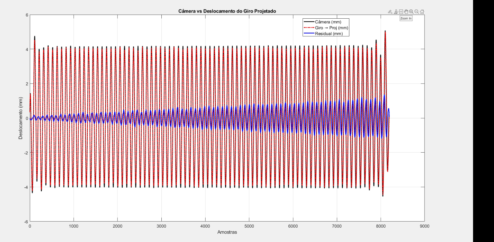

Hi @Sprite,
Thanks again for your help.
Iโ€™ve modified my code, and now Iโ€™m able to synchronize both signals (ESP vs. commercial system).
Iโ€™m attaching the signals below.
Thank you very much for your support!
