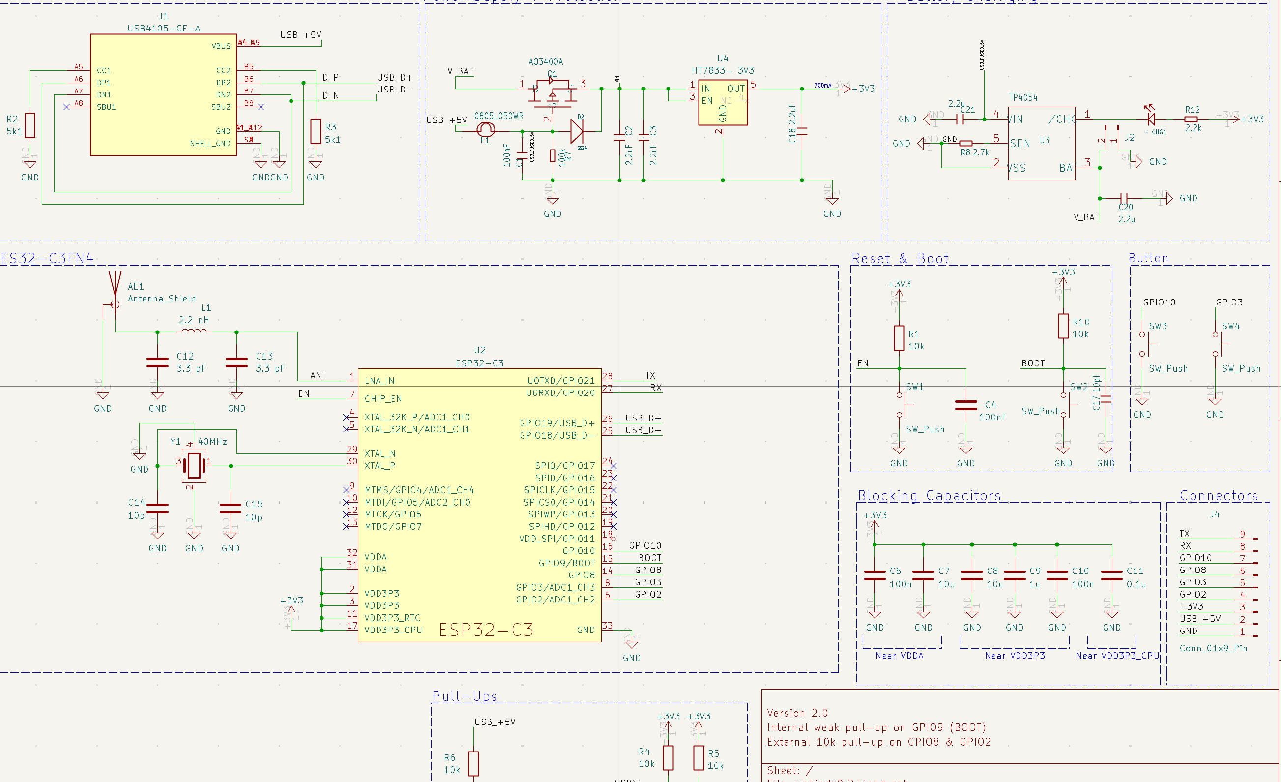

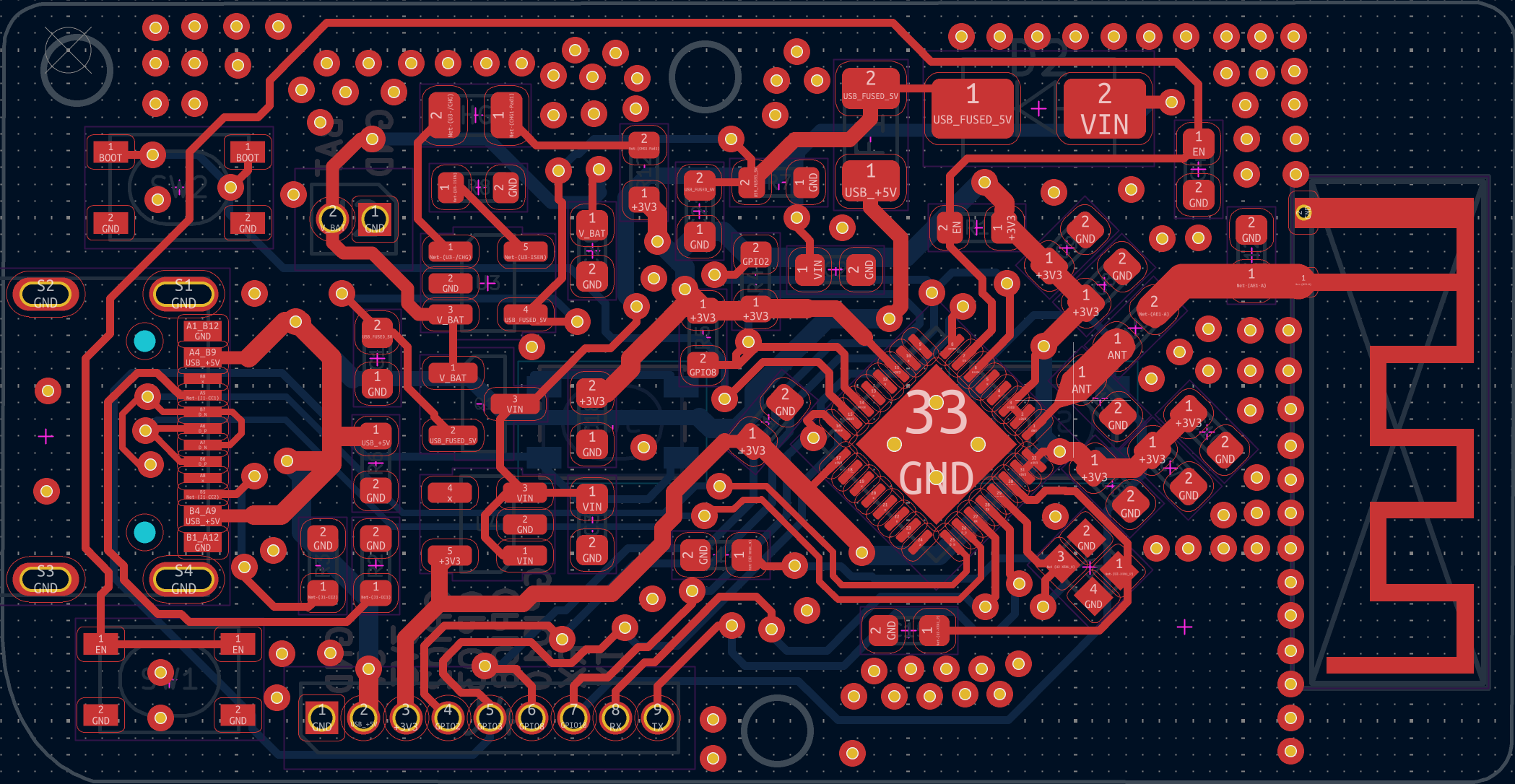

I'm working on making my own custom board using ESP32C3 but after I flash the code and the board starts running BLE I cant scan the board name on my phone on nRF connect app. I provide you LOG ​​monitor and schematic custom board and PCB. I can provide any information you need to help me with the problem I am having. I don't have a VNA device to test if the BLE Antenna is working or not.
All the information you provide and your help, I really appreciate it. Thank you.

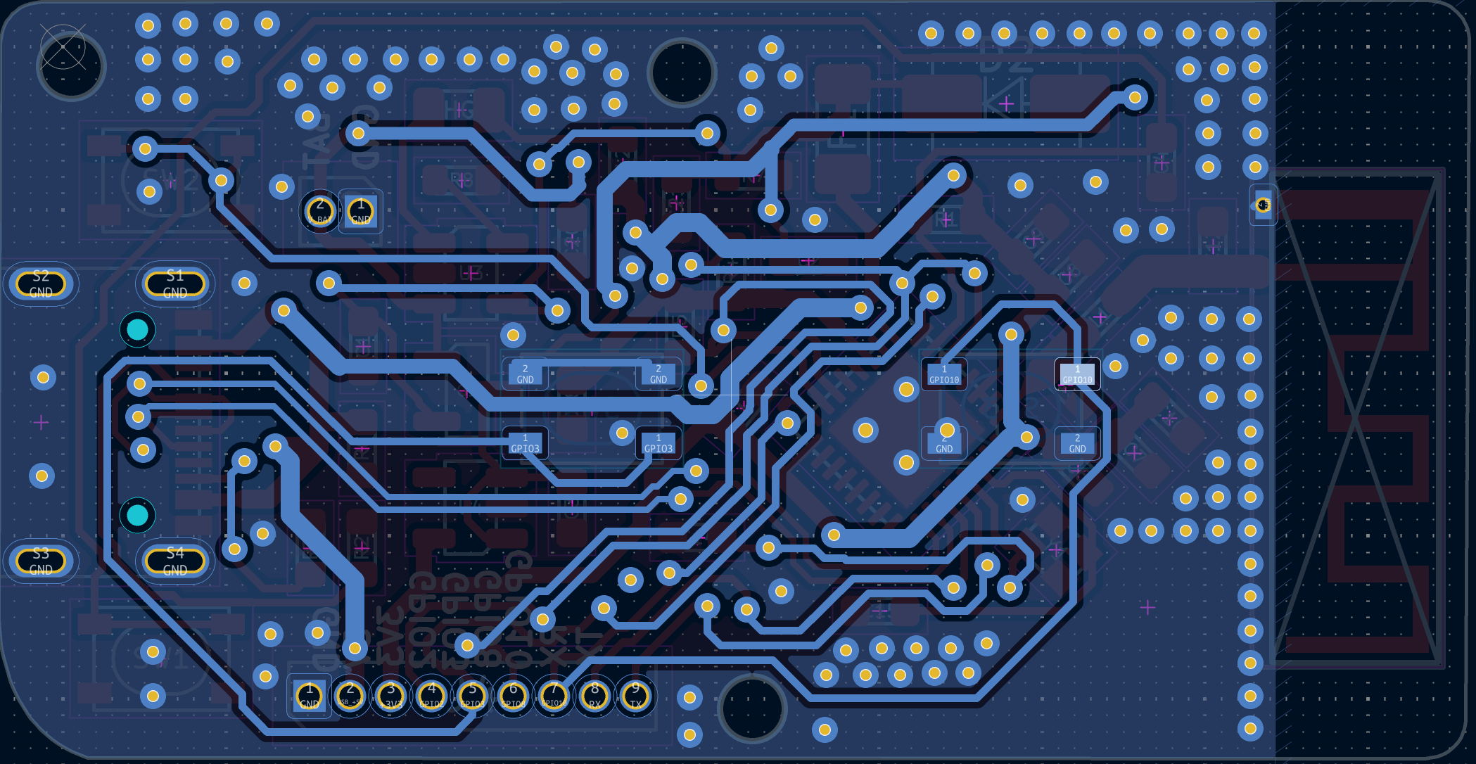

Postby Huy_Tran_DF » Thu Oct 16, 2025 4:44 am
and Back Copper Layer
