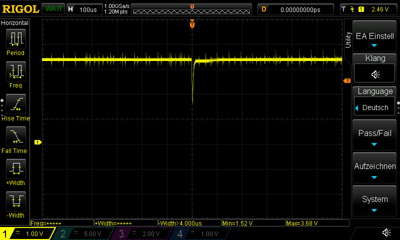

Here I did some comparison of different modules:
a) ESP01 - wake OK!
ESP01 OK
b) ESP Wemos D1 mini with 12-F module - wake ok:
Wemos D1 mini with old ESPmodule OK
c) ESP07-S - wake NOT OK:
ESP07-S NOTOK
Hasenradball
Posts: 7
Joined: Fri Dec 12, 2025 8:31 am
Re: ESP12-S and ESP07-S having problems to wake from sleep
Postby Hasenradball » Sat Dec 20, 2025 12:17 pm
Here the 12-S module - wake NOT OK:
ESP12-S NOTOK
Hasenradball
Posts: 7
Postby Hasenradball » Sat Dec 20, 2025 12:19 pm
It shows the ESP12-S has the shortest pulse of all but also the ESP07-S does not wake up.
It is difficult to extend the pulse with by adding some resisors or else.
So there has been some schematic changes with result is this issues!
